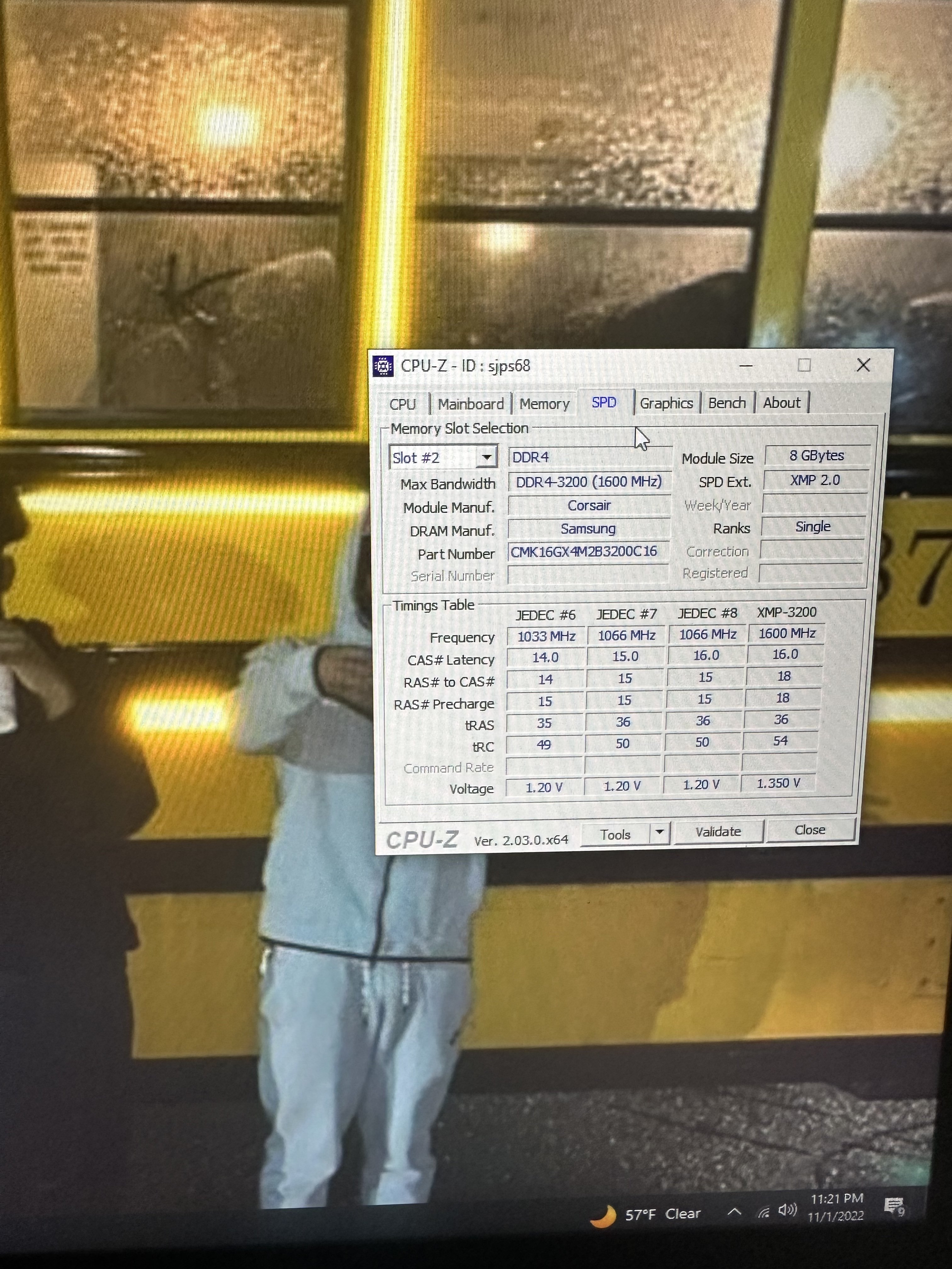

I build my Pc about a month and a half ago Ryzen 5 5500, Gtx 1660 super, asus prime b550-M-a(wifi), 2 8gb corsair vengeance, evga 600w 80 plus gold, wd 500gb ssd m.2. Not until a couple weeks i just kept randomly crashing in games like cod, rocket league, Fortnite etc after maybe like 5-30 minutes of playing or maybe just in the menu. finally today i checked the event viewer and seen Critical kernel-power event i’d 41(63). Now i’m pretty lost on what to do and upset on how much i spent on this build i need help asap. Even when i’m just in the background desktop it will just crash

I'm surprised nobody responded by now, any luck fixing your problem? That error happens when there's an unexpected shutdown.
I would have suggested benchmarking CPU alone then GPU alone, then testing RAM, but not if you're crashing when on the desktop with no games or heavy workloads running.
