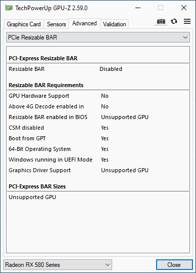

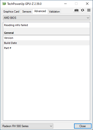

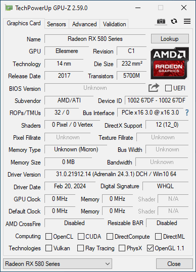

Hello,
I just bought a used HP RX580 4gb as a replacement to the same part after the old card died. I get no display when the card is plugged in, but it is recognized in the device manager with a code 43. I checked on GPU-Z and it reads the Bios as unknown and under the the AMD BIOS category in the advanced tab, it shows no information. I thought maybe flashing it would help, but everytime I try it gives me the "failed to load ROM" 0FL01 error. I have tried on 2.93, 3.04, 3.31, and 5.0.567. I just wanna use this to play games, I dont know what steps I should take, or what to do next, so any tips would be amazing. I will also add, I do not have integrated graphics, I am using window's remote desktop client.
I have the HP Pavilion Gaming Desktop 690-0034.
