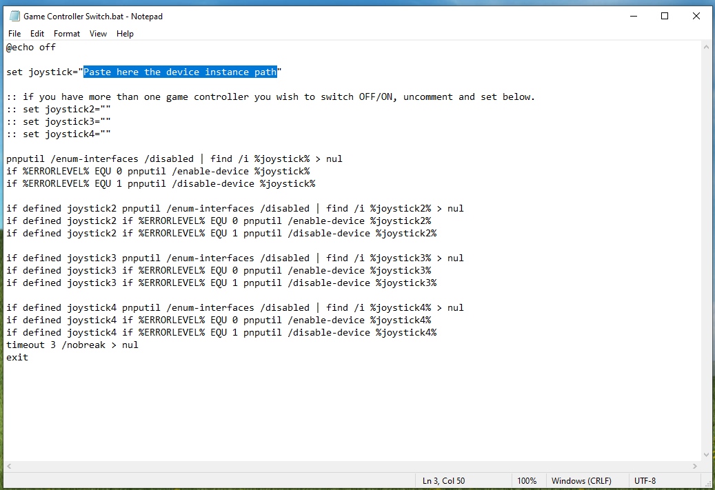

Method 3 - THE ONE THAT ACTUALLY WORKS!
Just disable (or unplug) the game controller when you're not using it. You can either use a USB hub with an OFF/ON button, or just use the following script to turn the device OFF/ON:
Download this file and extract it anywhere you like. Right click on "Game Controller Switch", select "Edit" and keep it open for now.
Go the start menu, search and run devmgmt.msc, expand "Human Interface Devices", double click on your game controller, navigate to the "Details" tab, under "Property" where it says "Device description", change it to "Device instance Path" (just one item below), right click on the long string below "Value", select "Copy".
Go back to notepad, highlight where it says: Paste here the device instance path, right click and select paste, and then select "File" and "Save".
Now every time you'll run Game Controller Switch as administrator, it will turn OFF/ON your game controller depends on its last operating condition. Keep the controller OFF while you're not gaming and the system will sleep normally. If you have more than just one "problematic" game controller installed, you can add these to the batch file as well.
