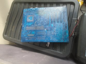

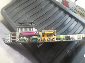

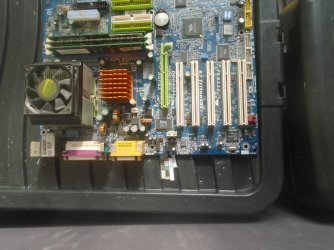

Somehow it is starting up ME on there..There was a smell of burning, it smells like it was on the board
