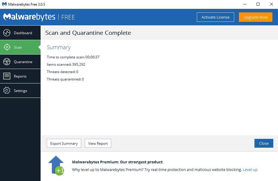

I'm searching for some problem that provokes invisible contextual menus, invisible windows on autocad and that chrome doesnt shows me the things I type on the website bar.
I'd do a thorough malware scan first.
Better to be the ditcher than the ditchee. ;)
no sign of ditches arround here
