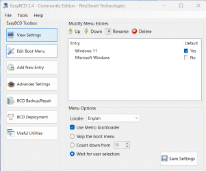

Download the latest version of EasyBCD then run it from sata drive
Got it how do i repair the nvme with it?

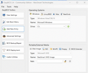

First - Ensure BIOS boot menu on correct choices so that OS can see all drives either NVME or AHCI
Add New Entry tab
- Locate the inaccessible OS on NVME drive i.e. C:\
Edit Boot Menu tab
- Hit Save Settings button
