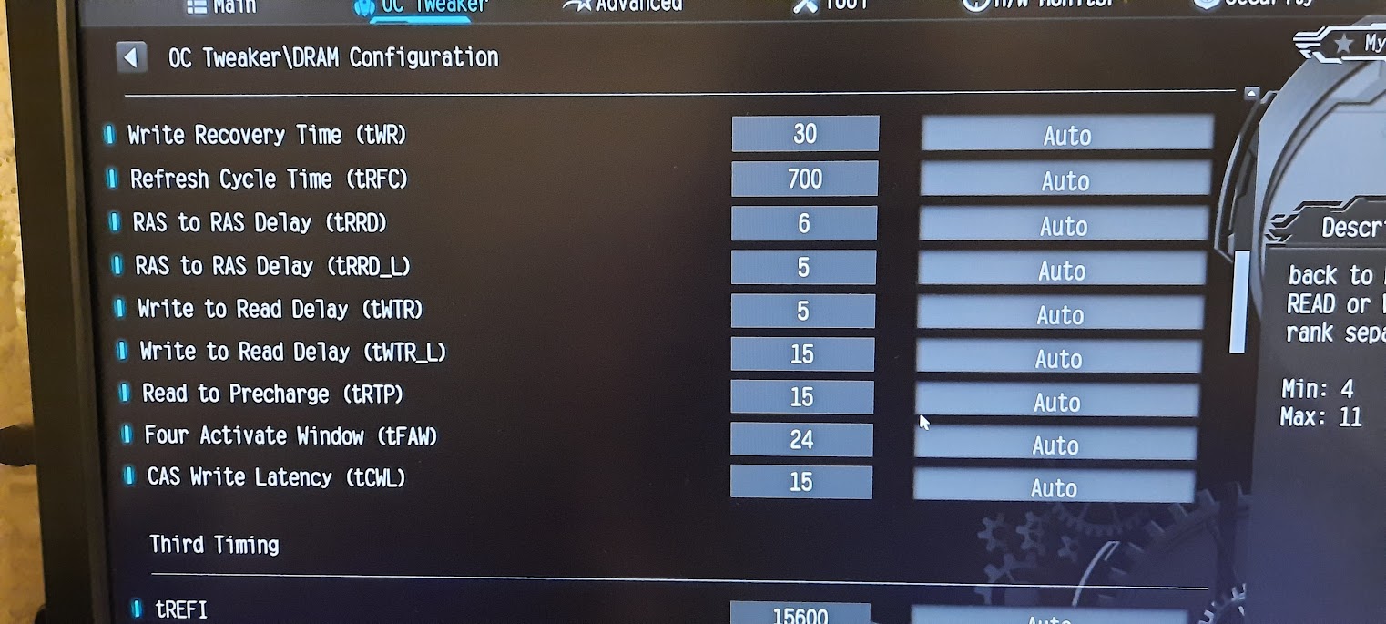

Hi!
I have 4x8gb Patriot Viper 4 Blackout 4133MHz PVB416G413C8K
Currently it runs at 4000-15-18-18-38-cr2 1.5v memtest passed for hour+.
I want to stay at 4000 but with better timings.
It is not stable at 15-16-16-38 (failed after 10-15 min) but runs games fine.
I think i must touch the subtiming but that is a lot of settings. I only want to reduce the latency a little because it is very high i think. (i have a lot of bandwidth but i want to balance out for the best bandwidth and good latency)
When i tried to reduce the tRFC to 400 it dropped out two channels. (need more system agent voltage or it is limited by the dimms?)
The dimms are just warm, not hot but i will put a fan on them if needed.
(it is on quad channel not dual)
Cpu is stable and tested so i want to work with the memory overclock.

Mesh oc is completed and stable, but how can i reduce the tRFC?
Should i increase the CAS for CR1?

I dont have gear down mode, it is not ryzen. I can set CR2 or CR1 but it only boots with CR2.
4 sticks is the minimum for quad channel but i think 65ns latency is high for 4000mhz ram and CAS15.
I can't lower the tRFC, it is now at 700, i only tried 400 but failed (boots but win11 not recognizing all 32gb ram, only 16gb when i set to 400). So something is limitig that setting.
Do i need more voltage to VCCSA, VCCIO, Mesh, SystemAgent or to the vdimm?
Or i can simply try Trfc 272 x 2 = 544 because of the 4 channels?

Hmm, b-dies usually go a lot lower than 400trfc, my single rank kit likes to be around 130ns which is 256trfc at 3800mhz, can you test with just one kit of ram and see what it sets to on auto. Maybe your kit is dual rank sticks? Try again with 500trfc and then 600 if that doesn't work, you can adjust by lower amounts once you've found the stable area.

Command rate capable will depend on the PCB revision of the memory.
Use Taiphoon Burner to check Eeprom. It'll tell you the PCB revision. Generally A2 is good for only CR2 while A0 and A1 have an easier time with CR1.
Here's what the differences look like physically
Also, B-Die scales really well with v-dimm. So much that you can be conservative with SA and IO voltages.
I have reduced the tRFC 600 and its working.
with 544 one channel lost
with 400 two channel lost
default is 700 (is it possible that quad channel doubles the Tref?)
So 600 quad channel is like 300 in dual channel?

with 544 one ram is missing:
With CR1 its not booting, error code 33
A0 all dimms.

That's 7th Gen memory controller for ya....
Desktop skylake is 6gen. This is skylake-x, total different. Yes it is almost maxed at 4000mhz. I have a big custom loop so voltage and temperature is not an issure.
Desktop skylake is 6gen. This is skylake-x, total different. Yes it is almost maxed at 4000mhz. I have a big custom loop so voltage and temeprature is not an issure.
Nice setup man! Holy ship!!!
The memory controllers are hit and miss. And yours doesn't like the 4 sticks, which is pretty normal for all setups, even if it was ddr2....
Performance top = 2 sticks, single ranked for B-Die.
I say pull 2 sticks and keep pushing. If you're trying to be competitive anyways.

Dual ranked two sticks is actually optimal.
I went from 2x8 SR 4000/14 to 2x16 DR 3933/14 and it's still faster.
But on a quad channel setup, 4xSR is optimal.
Your spec numbers may seem better with fewer ranks, but the actual performance in applications and games is still higher with two ranks per channel.

Dual channel 4600 SR does not beat quad channel 4000 SR.
And good luck getting more than 4133 on SkylakeX lmao.
Hi,
I'd personally just be happy with tight c16 timings and way less dimm voltage at 4000 only 1.45v should be plenty.
You should be able to push rfc down to 350 or 20-30 above where it won't post.
cke down to 7
refi double what it is at minimum max is somewhere around 45k
Right I already stated that. The memory controller....
And no competitive overclocker uses a 4 stick board for overclocking. Well some do, but pricing man.... That's why you buy into the Asus Apex, run 2 sticks, single rank....
For a daily driver, quad channel doing some work, I don't think it's worth the effort to find benchmarking numbers for sub 1% differences.
