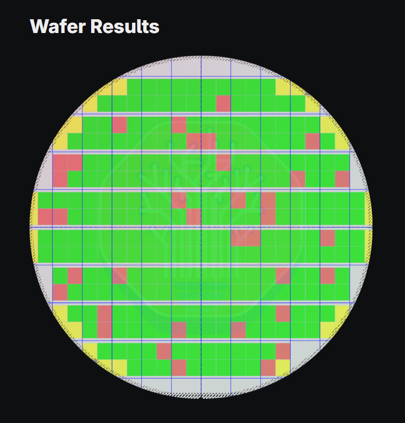

Trying to calculate the cost of the 5060ti chip, at 181mm square, I get chip cost $260. I inputted the x axis at 10mm and y at 18.1mm but not sure if that's right, and I picked TSMC 4nm as the node.

Ian goes into detail here. Check the timestamped chapter and the succeeding chapter.
The tool he uses: https://semianalysis.com/die-yield-calculator/
Looking at TPU's die shot of GB206-300-A1, it has a height to width ratio of 1.116. Solving for 181mm², that's 14.21mm by 12.74mm.
In the video he states N3 defect rate is 0.075 defects/cm² (28:29), 5nm-tier (N4/4N/N5) should be lower but we will use 0.075.
I don't remember if he said wafer price for 5nm-tier, but we will go with N2's $30,000 per wafer price: in the video he states that it will likely be closer to 20k or something for Nvidia as they are a TSMC partner, and N4 or w/e the heck 50-series actually uses should be even less.
Even with the generous overestimation of the defect rate and wafer price, we get...
$122 per die.
Again, that's with overestimation of both defect rate and wafer cost, and without even accounting for how some of the defective dies that NV can use some of the defective dies for 5060.

edit 2: at 35:81, Ian uses $20500 for N4 wafer cost and 0.07 for defect rate. Using those numbers, it would be $82.33 per die.

View attachment 396573View attachment 396574
$122 per die.
Again, that's with overestimation of both defect rate and wafer cost, and without even accounting for how some of the defective dies that NV can use for 5060.
