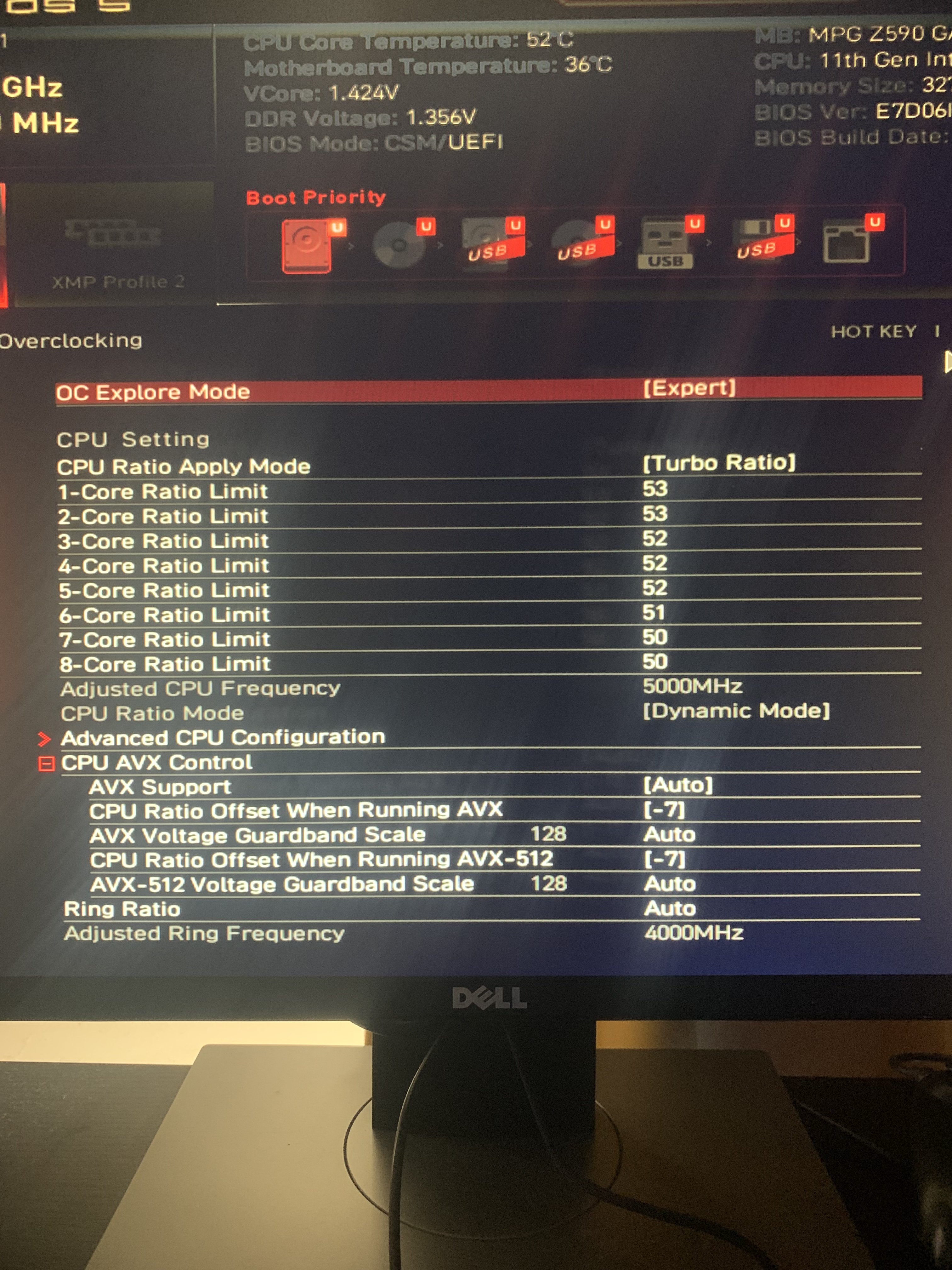

Ok, question thou. Please see the attached , I have 2 values set to -7 .. will I need to set them both to 0 for that to happen? Also is that harmful?
If you set them both to 0, it will not change the frequency for any AVX load, remember that AVX heavy loads generate a tonne more heat than any other load, easily another 100w or more compared to your current power consumption.

Yes, set it to 0 , run stress test.. temps started hitting 100c .. will leave at -7 or try something bit lower .. thanx
