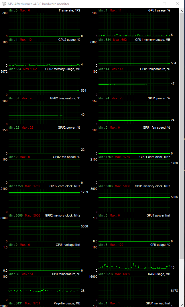

my afterburner works normally when i restart computer but after 5 mins the Vmem usage ramps up to steady 419185MB (which is not correct if any1 think so) i've tried to reinstall nvidia (DDU) driver and afterburner but still the same.. The only thing i can think of is either hope for a better nvidia driver or re-install windows :c
working:
https://i.gyazo.com/4f579156ff9ca06222b0db12289ef4e2.png
and then a bit later the mem buggs out: https://i.gyazo.com/0bbf176c3739e0b652b5e9443c7702a4.png

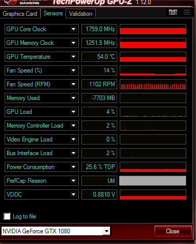

and in GPU-Z it says -7759MB:
GPU-z it says -7736MB
