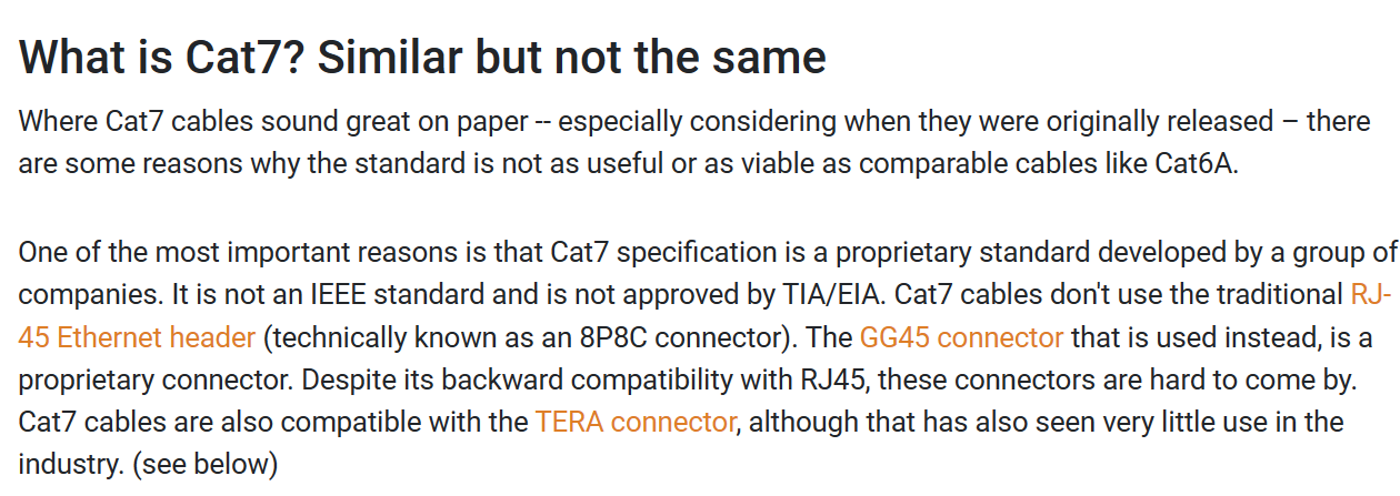

The length limits vary by speed and also rely on a quality undamaged cable being properly termninated at the ends
Cat7 is not a regular ethernet standard and is more or less made up bullshit - stick with 5e, 6, or 6a
Yes, its a standard - but not one made by the same IEEE group, and not one designed for RJ45 jacks
A lot of whats for sale is mystery cables, like how you can buy a USB 4.0 80Gb cable off amazon but it's a USB 2.0 painted blue

@Mussels CAT7 is kinda like CAT6 and CAT8..somewhere a lot closer to CAT6E. You can name the Cable 5,6,7,8. Its the MHz and working length that is the real thing that is important. Tighter twisted pairs, with each pair shielded is needed for true 600 MHz. I've bought a bunch of CAT6E that said 600 MHz on it. Even though it had outer shielding and pair shielding, still topped out at 900 MB/s. Oh the ends have to be shielded too if you are doing super long runs. I know the op isn't, but when your going across an entire warehouse (in my situation a TV station). Shielded stuff matters.
My point is that being a different standard that's basically non-existent means you can get a hell of a lot of fake garbage cables, since they arent actually being verified
The moment you use an RJ45 end in a normal network on those cables, they basically shrug and say good luck - and is likely related to the OP's issues with that rather long length cable
