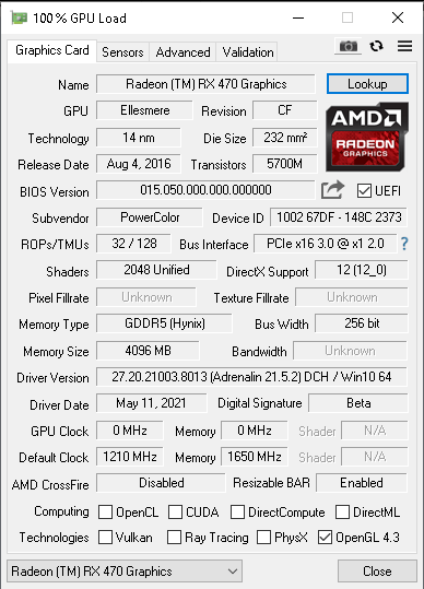

Hello I have PowerColor RX 470 Red Dragon 4GB with Hynix RAM
http://gpuz.techpowerup.com/21/05/30/e57.png
http://gpuz.techpowerup.com/21/05/30/r8q.png
I've recently bough it as a second hand GPU. It was probably used for mining. 99% the bis was flashed.

Current best - Last windows 21H1 with all the updates + Asrock H81M-VG4 r3.0 BIOS 1.20 (Updated from 1.10) + THIS BIOS https://www.techpowerup.com/vgabios/185897/powercolor-rx470-4096-160731 and the result is... the device manager now knows its rx470 but there is a yellow triangle (code 43) and the display is still in sleep mode.

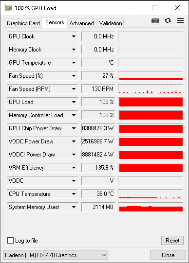

No, with the latest windows AMD do not detect amd device or its not working properly.One more thing the fans are spinning during the boot and when windows starts they restart every 5-10 seconds (spin-stop-spin-stop....)
This is when the gpu is set as a secondary, when its primary there is no POST
