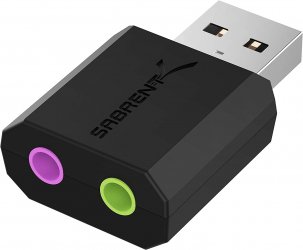

some times you can get an external sound card that plugs in to any usb port, they can some times help with console style headsets (ones with a Y splitter option, instead of mic & speaker in one plug)
something like this, just make sure it has pink (mic) & green (speaker)
