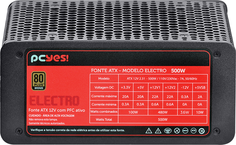

PCYES ATX ELECTRO 500W (here is a image with the complete specs: https://www.pichau.com.br/media/catalog/product/e/l/ele... )

That PSU may be a hunk of garbage. Never heard of the brand, not sure of the OEM and that concerns me.. It has a combined 40A on the 12V rail though so it should handle that PC without issue assuming it isn't malfunctioning and can handle its rating in the first place.

Is this the one you have?
Although I too have never seen or heard of one of these, doesn't mean it's "Bad" as in a poor quality - However you'd still want to try another PSU and see if the problem goes away or not. Using a meter with the above suggestion(s) is a good way to see what it's doing but access to the plugs while being ran is another deal.
Could be tested with the system itself outside of the case for accessibility to the plugs if it came down to it. However I do suggest at least being prepared to get another unit and don't cheap out on a PSU, it's at the very heart of the system and is probrably the most important piece of the entire build because all else depends on it to even function. Get a good namebrand unit, may cost more up front but will save you $$ and headaches like you're facing with this issue later.
I hope you don't have to replace it but if you do, get a good one and be done with it.

The OP made the thread and hasn't been back, so before anyone continues their disagreements and going too far off course, let's wait to see if they come back and provide any further information.
My two cents on this is simple, trusting software voltage readings can be a dangerous game that should be digested with a side of extreme caution. Also limiting to just one piece of software is equally dangerous, I'd use multiple such as HWInfo, HWMonitor, AIDA, etc., check BIOS/UEFI results, and also I suggest using a multi-meter as is suggested also in the post I have quoted here.
@Ewro please answer the questions below.
Updating drivers is not a very CPU intensive activity. The code though, the 0x124, is typically a low vcore thing (many see this while overclocking). So perhaps consider raising the voltage .05V and see if that stops it.
Are you at stock or overclocked?
Does it crash at any other time? Or only when updating drivers?
Does it crash when you stress test your CPU?
How about when you stress test the GPU? Both of those will use more power than updating drivers will. So if you can pass those tests, you know its something else.
Software readings can be inaccurate so its best to test with a multimeter where possible. That said, 5V and 3.3V are low according to that... check it out.
https://www.techpowerup.com/forums/threads/the-psu-rail-checking-guide.147571/
EDIT: System specs would be good as well.
The Exiled Airman
Jul 2, 2007
44,283 (6.80/day)
System Name PCGOD
Processor AMD FX 8350@ 5.0GHz
Mouse Roccat Kone XTD
Keyboard Roccat Ryos MK Pro
Software Windows 7 Pro 64
That 2001 testing tutorial is really way out of date, and not conclusive anyway. It does not test under a variety of expected loads, does not measure ripple, and does not specify allowed tolerances.
The only way you can conclusively test your PSU is with an oscilloscope under a full range of loads or with a dedicated power supply analyzer - sophisticated and expensive test equipment typically found only in electronics repair facilities and used by properly trained and qualified electronic technicians.
This leaves most users with the next best option, swapping in a known good spare PSU and see if you have the same problem.
The ATX Form Factor standard allows for ±5% tolerances. Therefore, the acceptable tolerances are:
12VDC ±5% = 11.4 to 12.6VDC​
5VDC ±5% = 4.75 to 5.25VDC​
3.3VDC ±5% = 3.14 to 3.47VDC​
So according to Speedfan, your 3.3V and 5V are too low. I would verify with another monitor. I recommend HWiNFO64 but note the shear amount of information it provides can be overwhelming so I recommend you check "Sensors only" when it first starts, then scroll down to your motherboard's section and check the voltages there.
But note it is important to understand software based monitors rely on very low-tech and often inaccurate sensors. So again, we are back to swapping in a known good supply to be sure. Since everything inside your computer case depends on good, clean stable power, this really needs to be done before you spend any money on anything else.
The Link I posted still applies today because not everyone has a Shop Locally that even have load testers or O-Scopes, and most end users that ask these kind of questions are not going to buy equipment they may only use once or even try to interpret the readings. I'm the exception because I'd rather not have to drive in Houston Traffic @cdawall knows this lol. So once the op trys the stated above if he comes back the topic is cold.
