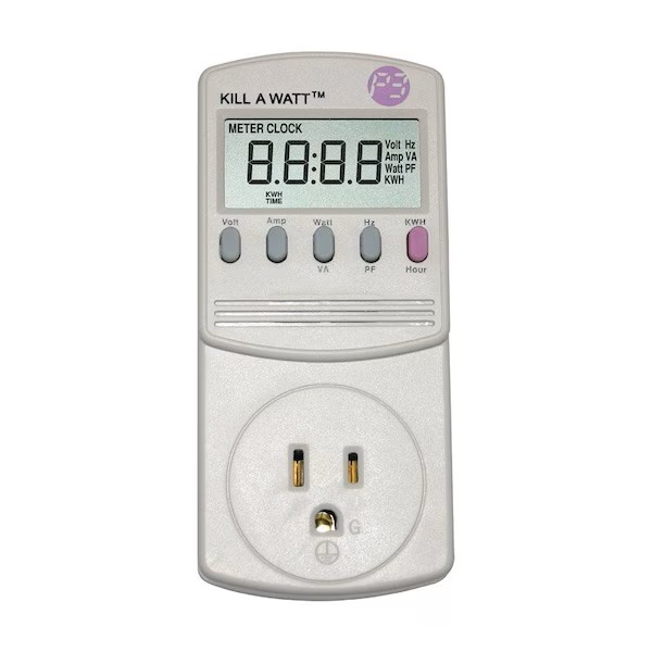

I find it very useful to have a power meter
I agree. Those can be very useful and informative. That said, many of the better UPSs have an integrated LCD status display panel that can also provide that same information - as well as error codes too.

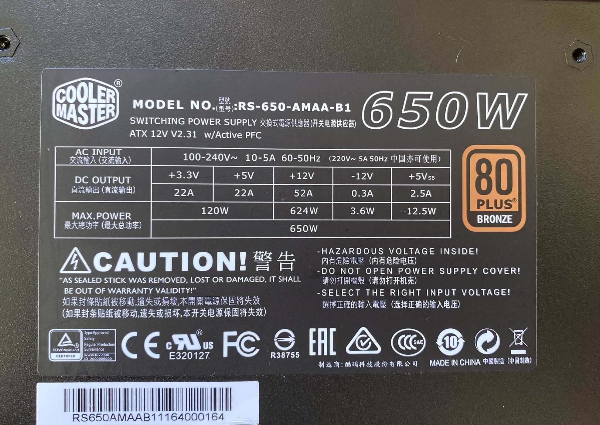

and you need to add all inefficiency of your PSU.
No you don't. That is accounted for in the rating.
If you have a supply rated for 500W supply, it will only draw from the wall (or UPS) 500W. If the computer components demands exceed that (including the amount lost in the form of heat), the supply will [hopefully!] just shut down.
Not to argue, but a 500W supply can supply 500W
So, if it is 80% efficient, it will draw 625W when supplying the rated amount.
No is not, its output of PSU, not wall power consumption, check like 80+ certification PDFs, or some tests, there is power draw from outlet, it will be more than rating because its the output power of PSU not the input power, as input power is your country spec, like mine 230V 50Hz 20A (mostly limited by breakers to 10A or 16A because you not need as much). Look at any sticker on PSU.
Yes, there is efficiency, losses on power conversion from AC to DC. AC power drawn is always bigger than DC output power.
:oops: Okay. My bad.
Still decaffeinated and worded it all wrong. Sorry.
My point was and remains that power "delivered" by the supply is based on the power demanded by the connected components. So the connected components require 500W that is what the supply will deliver, regardless if rated at 650 or higher.
