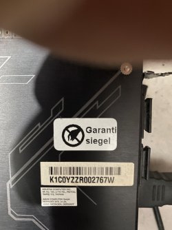

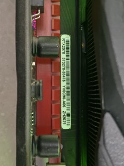

Get a sticker pic from the back of the card please
The reason it messed up is because W10+ love to update on own, plus mining doesnt help at all.

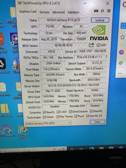

i havw just reflashed the gpu on windows with nvflash and same results i cant figure out what is wrong with it because i see some info not showing up well the first thing i have noticed after bios flash installed ok amemory type mismatch and the gpus core clock not showing this is the eeason that i belive it wont get to mine

Is it this card and not the O8G?

yes this is the exact card
i think they also called oc for overclock edition i belive it is the same type of gpu
This is the latest bios i can find.

By clock speed the bios i provided is the correct 1.

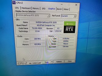

i dont think it has to be a memory failure just reflashed the gpu ended ok uninstalled drivers with ddu a clean install of latest driver intalled ok with no problem gpu has ben detectet pn windows but when i start gpu strees test it crashes and reboot the system. it cougt my eyes somehere due searching for rom something regarding the flashing that has to match the rom with the board something about A First variant and second variant gpu. this i belive is the problem that i am not geting any result till now

did we mentioned that the gpu we are talking about has a swithch that is for 2 roms and the gpu rom is diferent for the other when reflashed the bios samw results from both switches but one thing i jave noticed is during driver install on the secondary bios switch the gpu crashed during nvidia driver installation at 50 60 % after all i have concluded during those atempts i have made i jave noticed some mismatch on pci e to 1.0
the gpu after reflashed i did a try with linux on hiveos and after the startup no overclock at all applied just stock the gpu have very low power comsupion and stock settings not even closer at all so the gpu refuses to work and this is the reason i belive it os 100 % bios rom mismatch with the gpu because the gpu was not overclocked at all and not stresed if this is that you are refering
