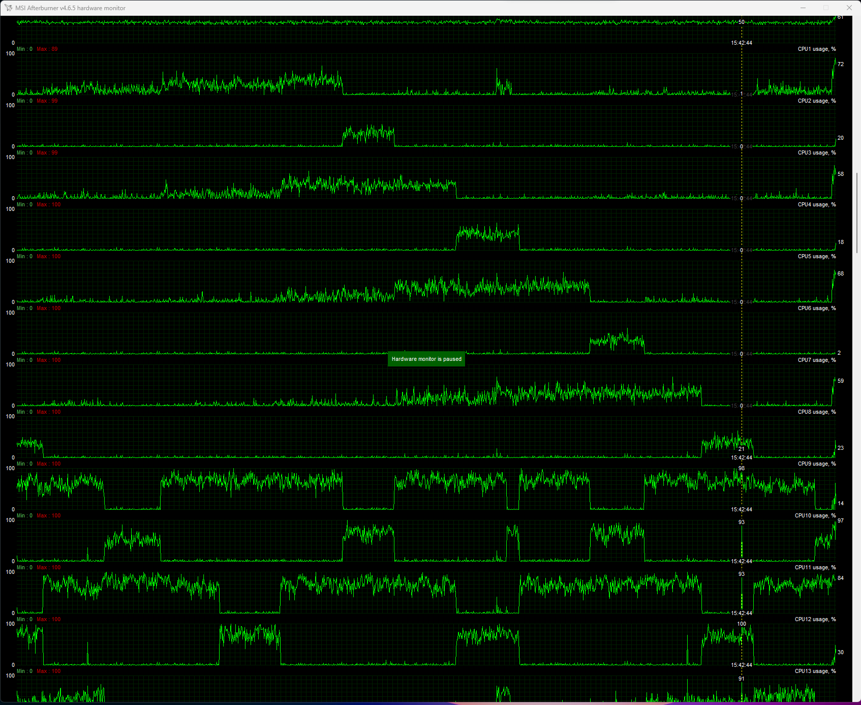

Also noticed in resource monitor, the blue bar that represents '100% maximum frequency' dropped like this in the picture during another lag event. Doing some research now to see if this is a reliable metric on what is happening. Maybe just all the resources are being used by something else at the time so it thinks the clock freq is dropping.

Still having issues. Tried replacing ram with new stuff and still having same problem. I'm thinking its a CPU or motherboard problem at this point but don't really know. I'm getting spikes across most of my p-cores it seems like, has anyone seen behavior like in the screenshots during gaming? is this normal or no? Still not having any temperature problems that I can see.

Honestly, looks like a normal CPU. Spikes probably background tasks. You have anti-virus software going?
Have you tried to do a fresh Windows installation? Nothing extra install but the game and see if that solves it? Might be some program running you don't know about

Update from yesterday.
Bought a new set of ram, no change.
Did a 30 minute cinebench R3 stress, and had no problems. Temps maxed at 89-91c
Uninstalled MSI Center. (was just using 8-10% cpu at all times for some reason)
Quit all processes for Corsair, I think this was mostly the iCue rgb stuff even though I had the program exited in taskbar.
Quit Intel driver update process.
Quit all razer processes, again the programs were exited but some processes were still running.
Quit MSI Afterburner monitoring.
Was able to play League of Legends for a few games at 144frames rather than 30 frames and did not have any problems. Had a 3rd party app for Lol running too which was good to see.
Still don't understand why most games are maxing out just CPU24 e-core, rather than sharing with the others, or using more of the p-cores, but maybe the games just aren't optimized for hyperthreading or e vs p-core usage.
Will start reintroducing programs/processes one by one and see if I can pinpoint the troublemaker. Thanks everyone for your insight.
