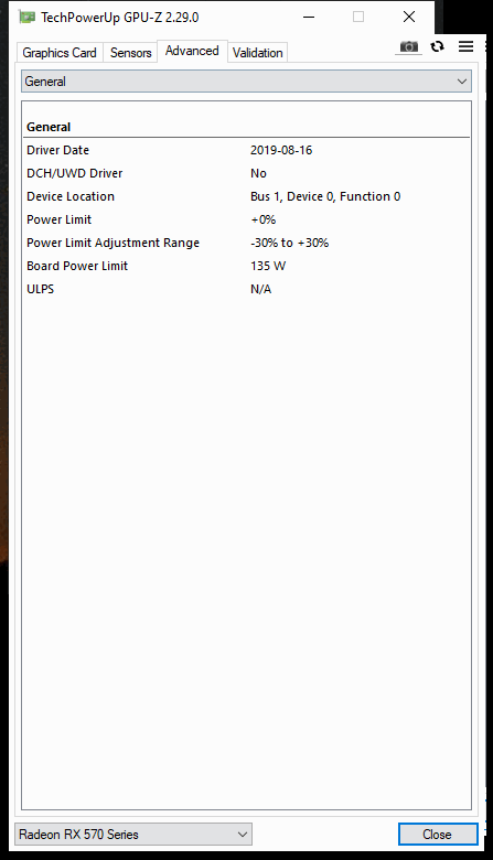

here are also some gpu-z pics
Get the sku sticker picture from side of card heatsink please, its by pci connector
