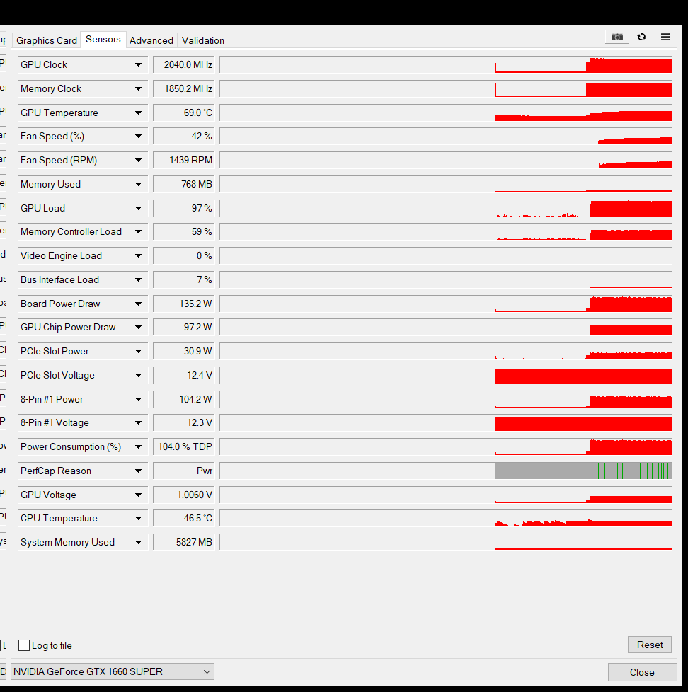

Ok I restarted and did the test you asked for, this time with closed case:
IDLE:
LOAD (FURMARK 1.22.0.0):
Here, a screenshot of FURMARK right after I took the provided screenshots of GPU-Z:
You are running the card at stock frequencies and it seems to me that the fan speed is correct for 72°.
Mine is 49% at 69° under load but here in Northen Italy is starting cold season.

It isn't warmer. It was until 2 days ago (37ºC or more), but today it got to 14ºC max. The room temperature was about 19 or less when I did that test minutes ago.
Now, sure, the card is reacting to the greater GPU temp but the room temperature didn't increase! That's why I say the card is getting worse: same room temps but gpu variation from then to now is about 8ºC! And faster fan spinning, lower boost clocks too...
No, my CPU stays the same, motherboard CPU VRMs too.
Now I just fired Furmark again and it was 52% at 72ºC. So, with Afterburner, changed the fan to 60% and it got to 71ºC, then to 70%, 70ºC...
About the heatsink, well it kind of moves when I thouch it...not the die baseplate section (if I remember correctly), but the heatpipes and the fins do move...

Temperatures vary day to day. Today is very cold, yesterday was cold, two days ago was too hot, the day before was brutally hot, all last week was WAY hoter than the week before. This week will be WAY colder than the week before around 18ºC colder in average. We are in spring and summer is ahead... I stated the room temperatures (in estimates). Don't know what's the confusion.
I'm getting the "same" performance in a way, the clocks are lower, the temps are WAY higher, the fan RPM's are WAY higher too AT THE SAME ROOM TEMPERATURES, AND GETTING WORSE.
As I said previously, I run Furmark only for few minutes. You know we play games for half an hour, an entire hour, hours...heavy games that put our GPUS to 99-100% load. Have the video card rules changed I wonder...?
Look at those temps!
Yep, something's not right here...
But hey! I get higher score in the stock setting :D
Room temps?
No, the diff in CPU can't be, at least in the sense that at 3.7Ghz mine isn't putting much heat and neither Furmark or Superposition use the CPU a lot and I have a tower cooler with the airflow to the rear directly to the exhaust fan...hmmm could it be my PSU?!?! Since I bought this GPU I'm getting a funny smell but I tested everything, and even removed the PSU and couldn't pinpoint the origin of that smell...

Also I noticed that pressing the backplate from the backplate and shroud the temperature decrease significantly, today from 76ºC with open case to 67ºC. And sicerely the card feels filmsy and all parts move when touching them. Like a cheap delicate toy.
That, to me, sounds like the screws came loose while it was being transported from the manufacturing facility because if squeezing the backplate and shroud together, if I'm understanding that correct, reduces the card's temp by 9° that means that there isn't enough contact between the heatsink and the chip. If you're worried about voiding the warranty you can screw the 2 that are diagonal from each other and that could work for now. That could also maybe be a reason for the smell? Is the smell something familiar like burning plastic? I'm not sure what thermal paste smells like so I can't help you there. If it is plastic and you can't find any melted wires then it has to be something enclosed like the PSU or an SSD/HDD. Also, try to take as close of a look as you can at the motherboard, maybe something shorted out in some freak occurrence that wasn't enough to kill the entire computer but could possibly lead to something bad if not looked into.

Pressing reduced 9ºC that time I said but I'm thinking that was a typo, maybe not. It does get lower but not that much (I think). 4 to 6 ºC depending on the room temp is more realistic. I just tested and got 4ºC less by pressing (from 73 to 69, see? open case same results. Worse even). While in idle, no reduction...
I did try to tighten the other screws ( I mentioned it above), although not in the proper way you mentioned, but they were tight already...which is bad news of course as I thought that was an idea...
Yeah is something like burning plastic or burning dirt maybe too...I did checked and re-checked...for days and frankly can't find anything nor other symptom. Sure it's worrying!
The only other new thing, since 3 weeks ago or so, that I never noticed before is a random faint noise, not a coil whine, it sounds more like a mechanical thing. It appears at random, sometimes few seconds, sometimes minutes. No correlation with what is happening in the computer...I stopped all the fans, stopped all my mechanincal HDDs, and still appears at random. No idea where it comes from.
do you mean you are turning the computer off? If that is what you are talking about and still hearing the noise then it can't be a part of the computer. Take out the power cable and hold the power button for at least 10 seconds to make sure that all the power gets used and see if the sound is still there.
No haha! You can stop the fans safely by pressing them by the center or disconnecting them, the psu fan I simply use a soft thing, like a straw. For the HDDs, configure the energy plan to stop the HDDs in 1 minute, wait 1 minute while not using them and that's it, or you can turn off disconnect them and turn on the PC.
Look, I found something!
I just removed the card and started inspecting it again. So I decided to make a video for all you to see how the damn heatsink moves
In the back there are some rubber stoppers, as in the video it's too dark you can see them here https://www.guru3d.com/articles-pages/msi-geforce-gtx-1660-super-gaming-x-review,4.html
Now I'm not sure now, and I will not do this again ,but it appears even the screws moves! And you can't tighten them more! How is it possible?! The last video card I had that did something like this was an EVGA 6600GT 128MB in 2005!! But that one didn't even had 4 screws! it had 2 (if I remember correctly) and rested on rubber feets! What the heck!?
Then, I made sure it was in a proper position, checked the screws again, moved it a bit and lastly pressed it by the rubber stoppers side and in the middle, installed, run furmark (sorry xman2007) and:
A ouple of degrees less closed case! Open case 68º (with 2 and half minutes, then I closed it, so probably 69º)! Also look at the temp curve is a bit different, and the fans % is a bit less too.
So (I think) it's as I was saying!! The damn thing isn't properly assembled (or whatever)!

I wouldn't go so far as it wasn't properly assembled. Who knows where the card was before you bought it. there might have been bumpy rides in the delivery trucks or someone was careless and dropped it when they were putting it on the shelf waiting to be sold. Contact MSI and see if there is anything that can be done. I know it sucks but if you can get a new card without spending much or anything at all then I think that's a win. Trust me when I say that a company would rather please the customer if it's simple enough than get that customer talking about how bad their products are, and this seems like a simple fix. I had something similar with my last computer and the CPU cooler, it was stock but designed so poorly that trying to take it out to put new thermal paste felt like I could have broken the motherboard and been totally screwed. I had to take out the whole motherboard one time because I couldn't get the cooler back on and couldn't get it off to try and see what was going on. Best of luck Fergutor.
