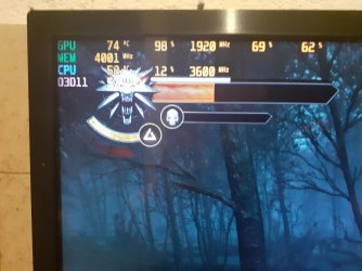

update:
On high details with hairworks ON it immediately goes to 99 percent usage and fans ramp up
the frequency is okay under the environment (it's almost 40 celsius outside)
Soon as I disable hairworks the load is fine and the fans as well
so my guess would be that after a certain point the PSU just can't get enough
power to the GPU and it behaves like this.
I tried reseating everything and it didn't help
the rails while in game are as follows:
12.192 V min 12.288 max
5.040 min and max
3.328 min 3.344 max
