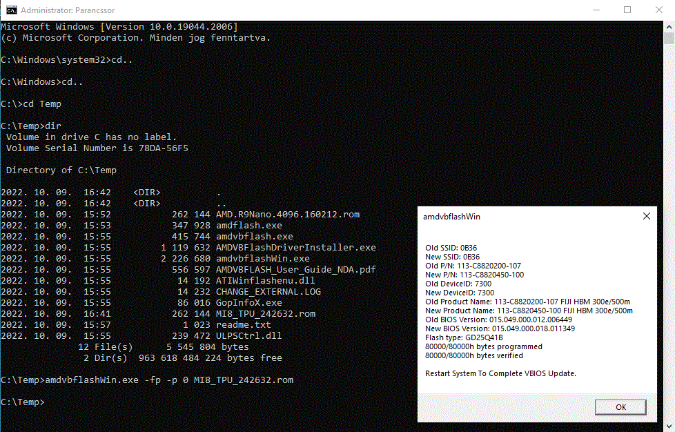

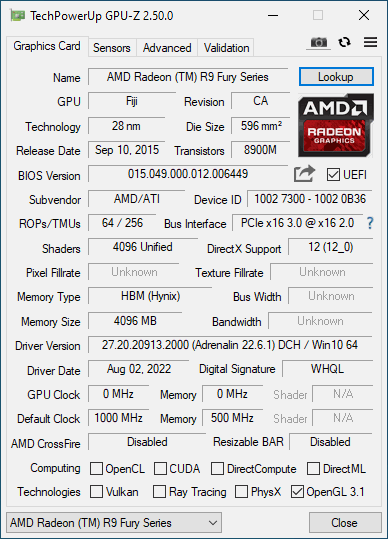

I bought a Radeon Instinct MI8 used, around 6 months ago. It came with a modded cooler: top of the aluminium frame was cut out and an 8cm fan was inserted. The fan was soldered to the bottom of the factory fan socket (not a nice solution). The BIOS was already modded (R9 Fury Nano), I attach this "original" modded BIOS. I tried it in a couple of games, it worked well. After that, I used it for mining RVN, it proved to be very efficient in this task. However the BIOS throttled it, every time it reached 74-75 degrees, it was downclocked. At first I swapped its fan to a more powerful one (still 8cm) and then I bought an AIO water block (ID-Cooling Frostflow X 120) and applied to the card. During this process I soldered off the wires of the fan. It worked for at least 1 month, the GPU never passed 55 degrees during mining, but then I swapped to a more powerful card in my one-card-mining-rig and used the card as a gaming card in my main computer. Sometimes I experienced freezing, comically not during gaming, but when using OpenSCAD. After a while one day my display remained black when switching on the computer. I took out the card, booted with the iGPU of my APU and realized that AMD radeon software was not running. I installed it once again as far as I can remember, put the card back and it gave signal again on its (originally) hidden displayport. But then again, display remained black after a few boots. I put it back to my mining rig, where HiveOS detects the card, however the mining programs do not detect it / say "Failed to list OpenCL devices on platform 0". I put it in a spare motherboard with Intel iGPU. When in the BIOS I force using the iGPU, I can install Windows, the card is detected as R9 Fury Nano and the appropriate AMD driver is detected and installed by AMD's auto detect program. After the reboot the driver says it does not work as expected and it quits. In the Device Manager there is exclamation mark near the card. In GPU-Z I can see it, however some of the information are missing, OpenCL support is disabled... see on the screenshots. After that I updated the BIOS successfully to an MI8 BIOS (unverified) found on TechPowerUp, but the issue is the same. What else should I try to make it work?

It's possible flash did not install correctly. Use a external programmer. Out of the bat you don't even have Vulkan API ticked off.
Situation was the same before BIOS flashing, so I don't think the issue is connected to it, however this card has dual BIOS, switching the switch to the other position does not seem to solve the problem :(
If I were to flash the BIOS with an external programmer, is this kit what I would need: CH341A programmer ?
And why is that all those checkboxes are empty? Do you know what does GPU-Z do in order to check support for these features? Why just OpenGL is present and not Vulkan for example?
Then you may need to check motherboard BIOS settings or check device manager making sure it's not the default microsoft driver. I have the R9 nano card & it's an easy card to work with when it comes to motherboard compatibility.
Your card is detected, but something is missing. Perhaps you should do a DDU & clear out all old driver setup & start afresh. When troubleshooting any GFX card, I always select "driver only" from the optional menu. This cut's down complications what could be wrong.

Your card is detected, but something is missing. Perhaps you should do a DDU & clear out all old driver setup & start afresh. When troubleshooting any GFX card, I always select "driver only" from the optional menu. This cut's down complicating what could be wrong with the install.
