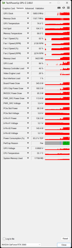

I am getting a PerfCap Reason: PWR when running games. I received this on both graphics cards, but I have plenty of power and did not have this issue with the system when I ran the 3080 originally before I got the 5090.
