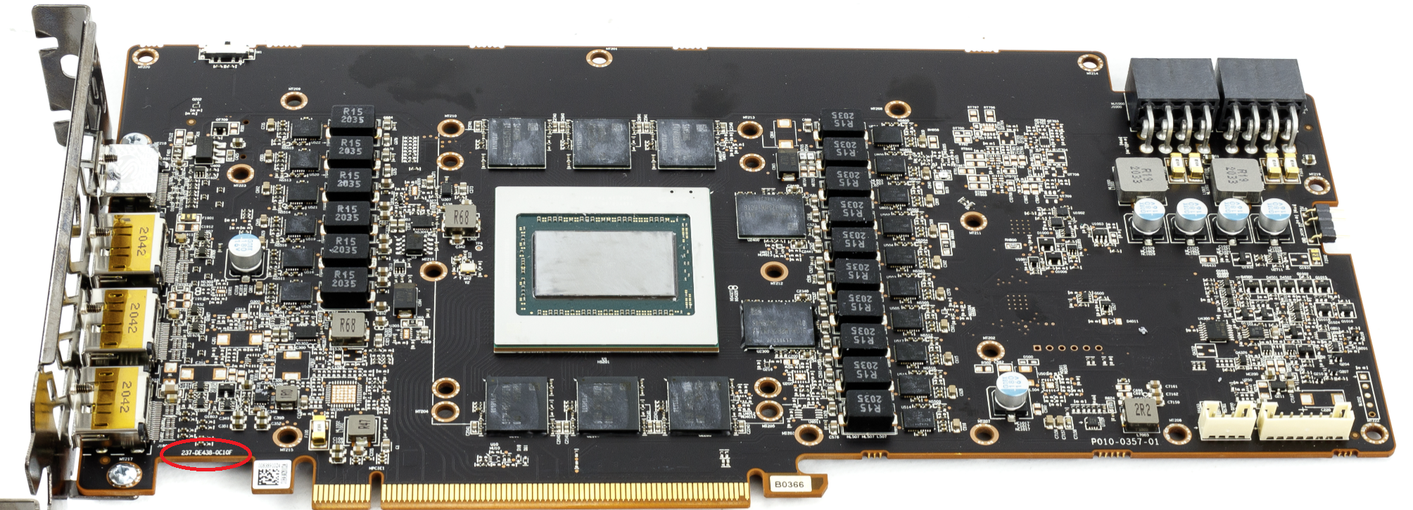

  4. Can you make a picture of the PCB on both sides?
  5. Can you share the part number listed on the cooler/backplate?

4) my GPU is already back together, and I don't have the confidence to take it back apart. Considering two technicians have taken it apart and looked at components, I am confident that there's no apparent damage that can be seen
5) Part number is S88-1E438-201SA
Can you confirm E438 is listed within the part number on the PCB?
Did you try the following bioses?
Performance bios:
Silent bios:
Yes, this GPU has the exact same part number as the photo you displayed above. I tried the 3 rom files listed as compatible on this website, one of which was a duplicate file. Each one gave no change in result. I also just hit the BIOS switch that is on the GPU between restarts of the computer to see if that would suddenly work since the flashing. These VBIOS files were in fact different from the one that was installed on my GPU prior to flashing, but none provided a display on screen
