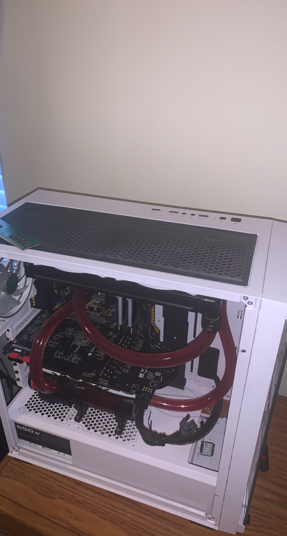

I mean some pictures of the inside of the case would be helpful
here are some pics lmk if you need more

Hi,
Looks fine as is except for the issue at hand

Yes of course it matters it needs to be mounted properly with the original mounting hardware. The CPU is probably hitting the thermal limits and shutting down to save itself.
after taking off the bracket and tightening the water block on the cpu the pc is now booting. thank you for the help!

Overheating
First off why does he need watercooling for a intel 9400f? little overkill for low tdp and a locked cpu, i personaly don't think its overheating problem, and also that's a werid config to have the reservoir and rad below that gpu makes no sense to me lol
