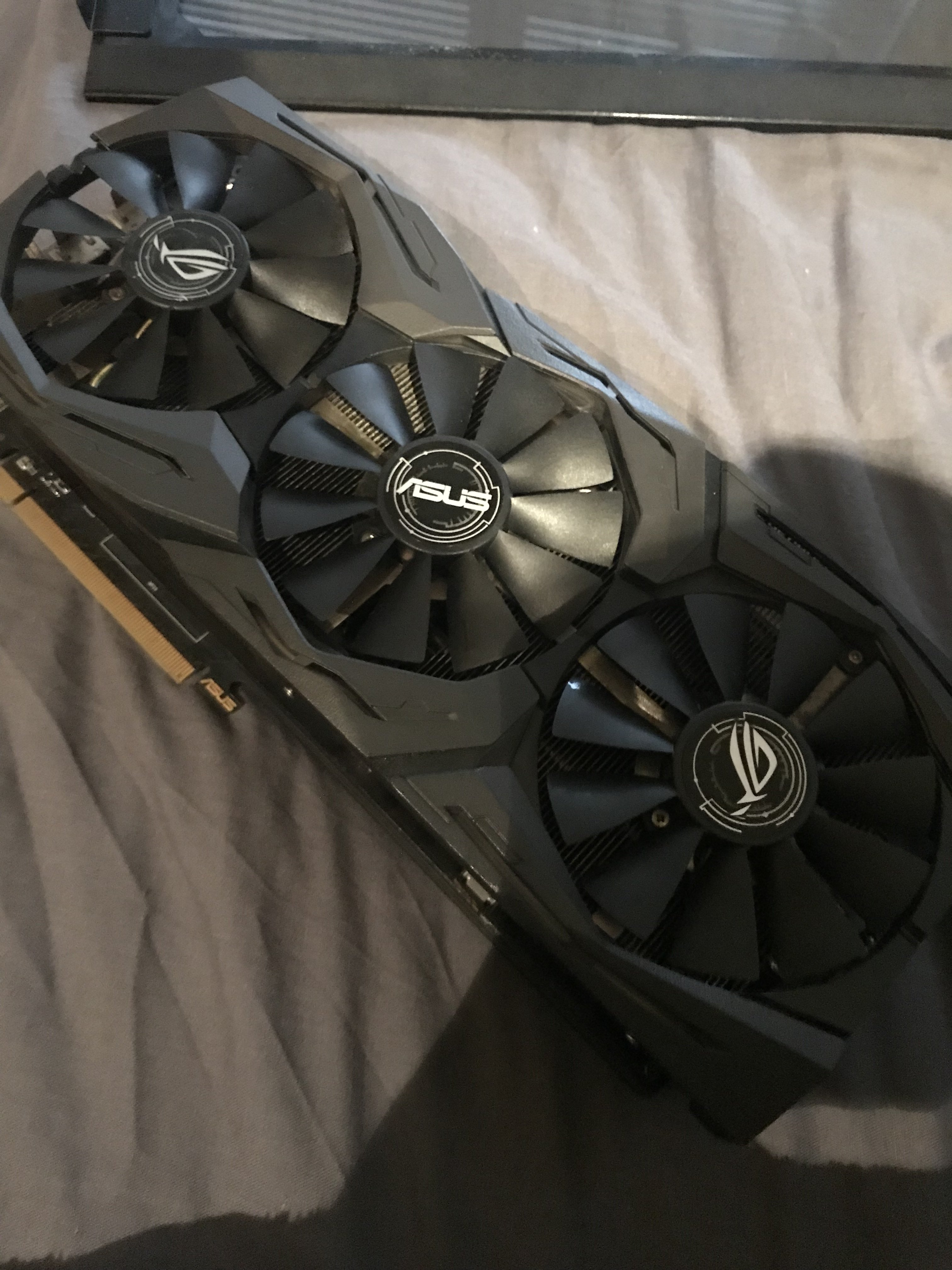

Hi my friend gave me his RX580 8GB GPU to attempt to troubleshoot.
Tested it in my mobo & his, there is no output, it’s no signal on the monitor and im 100% sure it’s not the monitor or cable as it works for the iGPU
GPU-Z shows clock & memory at 0 and bandwidth is unknown, among other figures either being unknown or N/A
I have updated my mobo’s BIOS, and reset it to default.
i have also flashed the GPUs BIOS and put in the stock bios.
I have updated to the latest drivers. I’ve reseated multiple times & switched between the two PCIe lanes on my Mobo.
I’ve looked into most forums and tried doing everything to no avail.
I suspect there’s a part of the GPU that might require a repair, but the only person I’ve found who can do that, doesn’t want to share possible problems without my paying him.

Give us a picture of the white sticker on the card. There's usually a part number or some numbers there that will help us identify the card
Pictures of the card itself will also help

I got a picture of it again it’s directly after the gigabyte logo.
I’ve also opened it up, I saw no warranty sticker so assumed he’d already done that and I see:
1. a lot of thermal paste, even around the main GPU
2. there’s a brown hard substance around some components, I’ve attached a photo below

Yeah i think your card is toast.
With blue lines like that - you could try a different port on the card (try DVI or DP if youre using HDMi etc etc) but I really think that the cards gone...
I dont even know what the hard stuff is but its either some sort of glue/epoxy or old thermal paste. If you poke it with a pencil and its super hard then it would be epoxy -- Somebody has tried to repair the card previously and done a messy job.
Depending on where your friend got the card from it might have already been repaired once then flipped it on ebay.
It looks like somebody tried to repair the power delivery system. a good electrician will probably be able to sort that out but it depends if youre willing to pay the repair fee that he demands.
what the hell did they do, you can see that stuff under the thermal pad too.
I honestly don’t know. I wanted to try DIY it then I saw that and immediately just chose to steer clear because I don’t know what’s going on there
