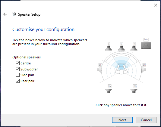

Should work as normal based on the UE5 documentation: Audio Files in Unreal Engine | Unreal Engine 5.1 Documentation
I have read Dead by Daylight has a past history of audio issues, but I guess you unticked headphones?
In terms of side or rear for 5.1, side should be converted to rear if side is not present in 5.1 mode, and visa versa.
Weirdly the analogue standard on my S1220A and other chips I have had is front-rear, no side.
I also believe the standard for DTS Interactive and DDL 5.1 is also front-rear, but I could be wrong.
Currently I am setup with as 7.1 -side, as 5.1 with virtual side (ch 7-8). Registry data.
Either way, even if the conversion does not take place, you should hear centre.
If you use analogue, and set 7.1 and untick side, then press side, you should hear it between front-rear.

I tried both. Ticking/unticking headphones does nothing. 5.1 audio works fine with analog audio cables.
When I say "5.1 audio doesn’t work", I mean, I can’t hear anything from speakers + audio recording software (I use OBS) captures only 2 channels.
Another Unreal Engine game Vampire The Mascarade: Bloodhunt has a setting called "Home cinema". Same problem. No 5.1 audio through SPDIF interface, 5.1 audio with analog cables works like charm (it’s a free game, by the way).
