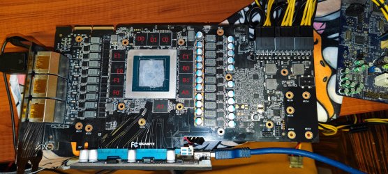

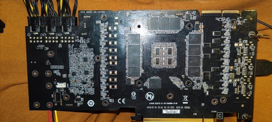

Hello, I know that normally the vram names are listed as in the photo. But in the RTX 3090, there are the same number of vrams on both sides. And the mats tells me that there is an error in the c1 and e1 vrams. Which side should I remove?
