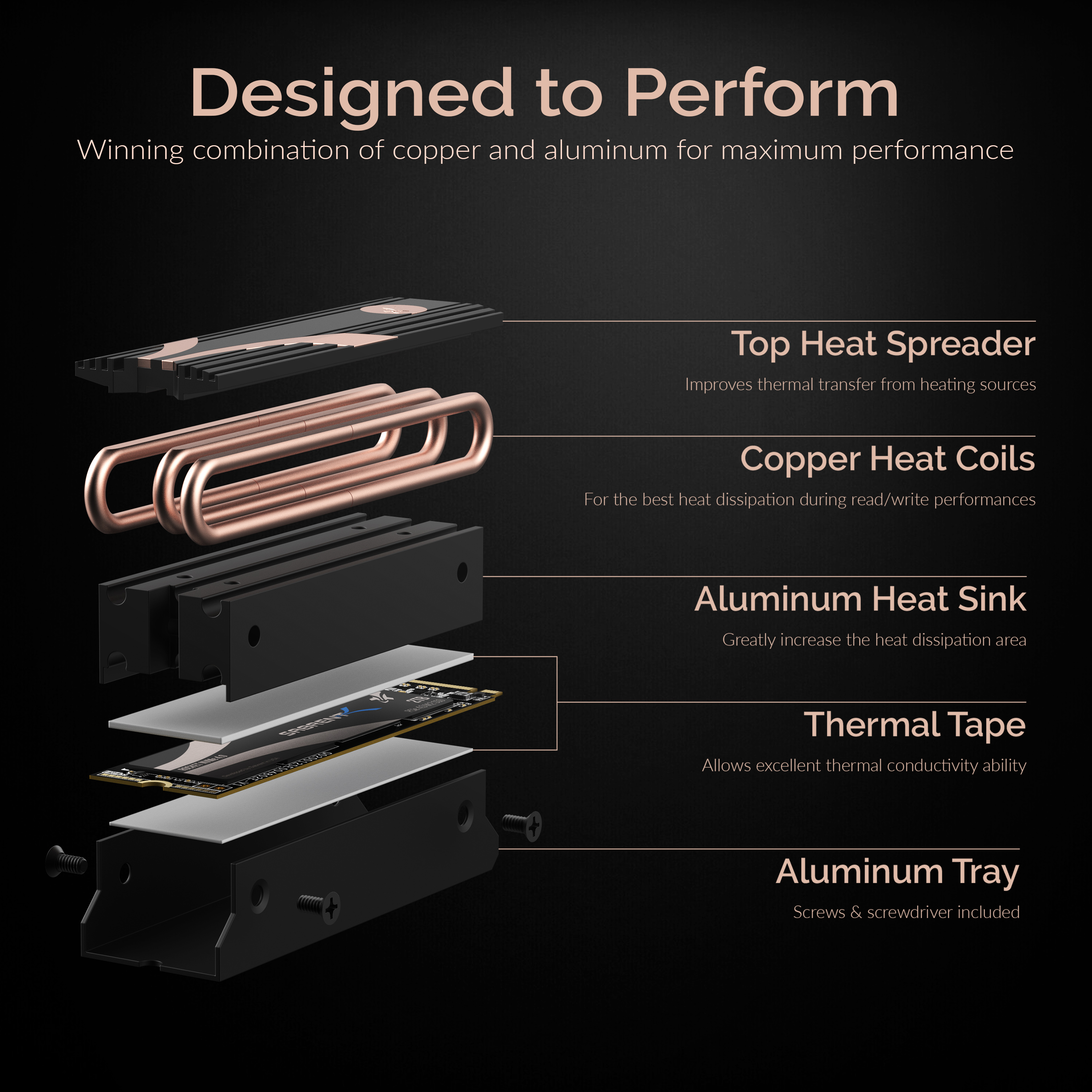

Get better cooling for your NVME drive ? ( like suggested above if that's possible ), improve the air flow around problem area.
Sabrent's Rocket 4 Heatsink is pretty sweet, although this will only fit on the lower side of the motherboard.
My Samsung 970 EVO 1TB NVME PCI-E 3.0 runs at 50-60c which is a lot hotter then my Sabrent Rocket 4.0 2TB NVME PCI-E 4.0 at 39-45c even doing gaming and they both have the same kind of heatsink on my Asus ROG Strix B550-A Gaming motherboard so my Samsung drive most be hotter even it has a better airflow access in my Fractal Design Meshify 2 White case where I got 3xXPG Vento Pro fans in the front and 2 in the top while using a AIO which have it's rad mounted in the front.
