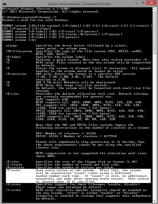

    Actually, if the OP is using Windows Vista or better, flmatter is correct.
    Quote from About.com PC support pages:
    Screen shot of Windows 8.1 "format /?"
    Frick, Ahhzz, Jizzler and 2 others say thanks.

    Yes, I don't believe you can format the system drive from within windows.
    If you have a need to wipe the system drive... they would need to make a system repair disk; or ,as known in windows 8/8.1, a system recovery disk.
    As far as I understand, windows 8 can make a DVD or a USB drive system recovery; however, Windows 8.1 can only make a USB drive one.
    But, you can, also, use the 8/8.1 install disks to boot into the repair options. (if you have them or obtain the ISOs and create them)
    They can boot to any of those options and use the command prompt with the proper format command and attributes to format and over-write any drive.
