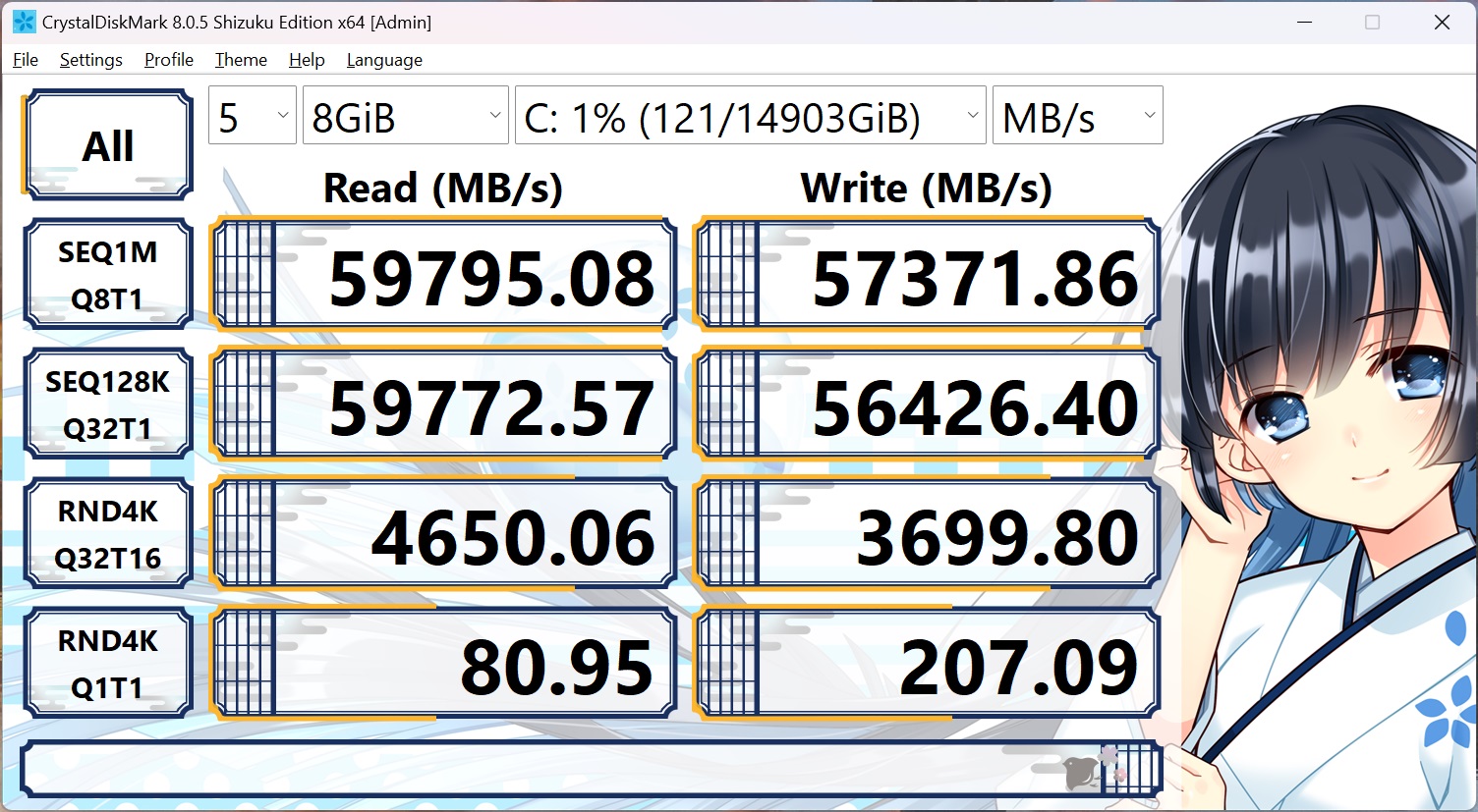

A total of eight Crucial T705 GEN5 SSDs installed as Windows bootable RAID0.
Come attached with two CrystalDiskMark results, one with dual R7608A RAID AIC(4x Crucial T705 GEN5 SSD on each card), the other with single R7608A(with 8x Crucial T705).
The settings of CrystalDiskMark has been resetted to default after testing.

The Windows bootable RAID read speed hits 106GB/s

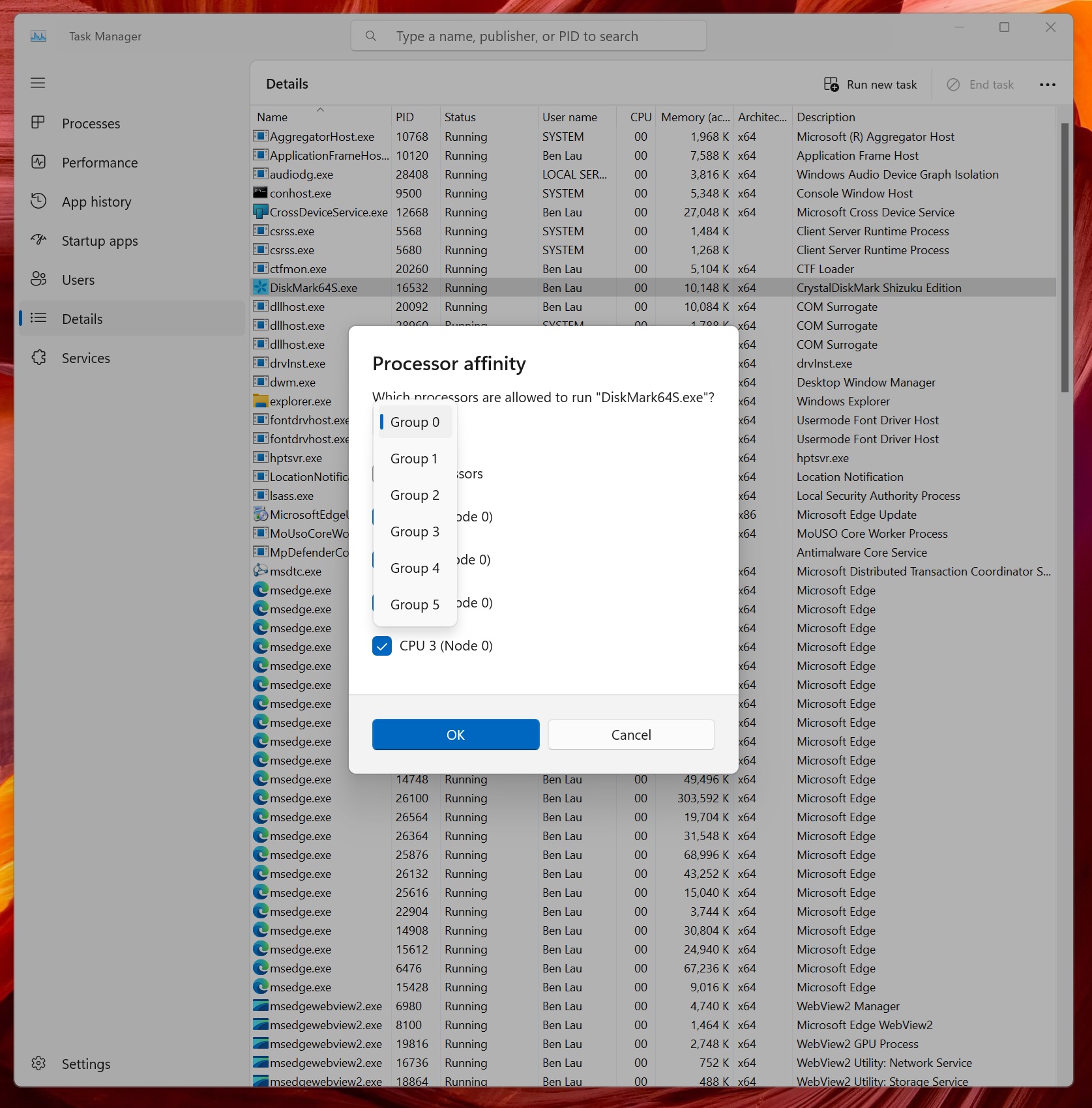

As the HighPoint R7608A cards are installed on slot 4 and slot 3(CPU0), I have to set CrystalDiskMark to run on CPU0.
PCIE5.0 x32 has a tranfer rate of 64GT/s (real world ~120GB/s). As I am just a rookie in computer tech, I could only hit 106GB/s and are unable to harness the full strength of PCIE5.0

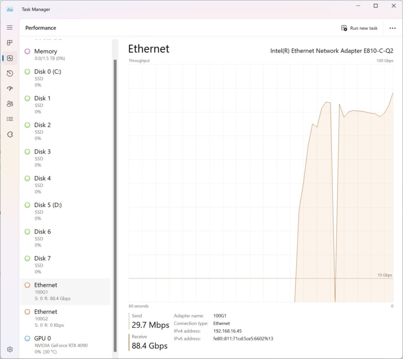

Yup, there is backup in my NAS(pic below) and my home network runs on 100G QSFP28 optics
My i9-14900K PC has built-in 10G RJ45 port and also runs on Windows bootable RAID0
Sorry, I should have been clearer in my query. I wasn't asking about benchmarking apps. Instead I was enquiring about the intended use for the computer, e.g. are you using it for coding, rendering or AI LLMs? It must be something that warrants high speed storage.
With the likelihood of one or more of the 8 RAID0 drives eventually going down and taking everything with it, I assume the data is ephemeral and copied elsewhere?
I cannot see any storage drives in the Windows system. Are you throwing data over a 100GbE QSFP28 fibre optic link to fast storage in another machine?
My 100G QSFP throughput
