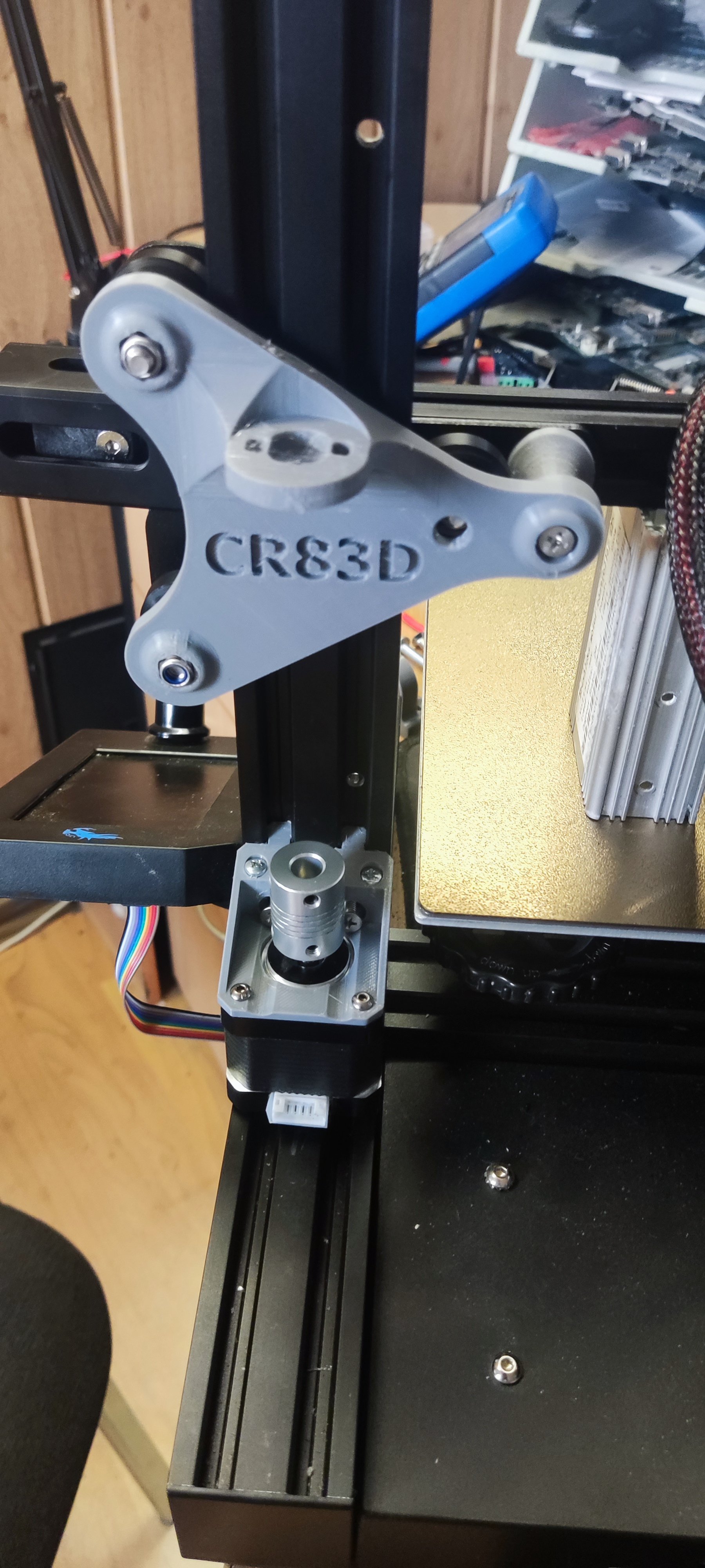

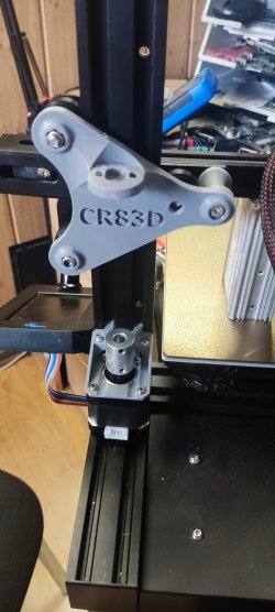

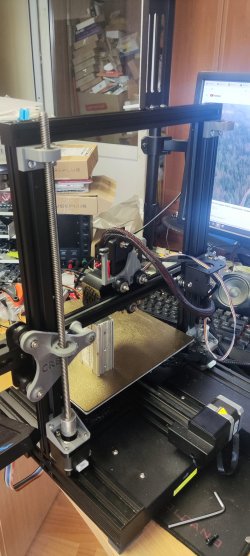

Almost done. I was waiting for my bolts/nuts and T8 lead screws to arrive today, but the package got delayed.
Still, managed to put it more or less together with whatever I had at hand. All I have left is to put in lead screws in, do some calibration, and maybe a few test prints.
Printed motor mounts, gantry backplate and everything else worked like a charm. I only had to print different motor mounts with T-slots, cause M4 T-nuts I ordered won't be here 'till Friday, and my friend needs it by yesterday... as usual...:kookoo:
Finally all parts arrived. I was too busy and forgot to snap any pics, but tomorrow I'm going to flash mriscoc's firmware and do some calibration and testing. Already got my transmission ratios for the new extruder, leveled a gantry and tested my dual-motor setup. Everything works as expected. Stock firmware really sucks. While the new version at least got a higher max transmission ratio for the extruder, it still caps extrusion speed to only 50 (which is unbearably slow with 3:1 gearing). Also need to check the encoder on LCD (i think the push button does double-click and won't let me exit menus every other time).
Also, since I didn't have a proper y-split motor cable and I was too lazy to crimp a new one, I found some 4p XH2.54 connectors on my "dirty work desk" and a 4-pin pigtail from something, made a small ghetto-splitter in ~2min, and reused a leftover short Z-axis cable from my old Ender3v2.

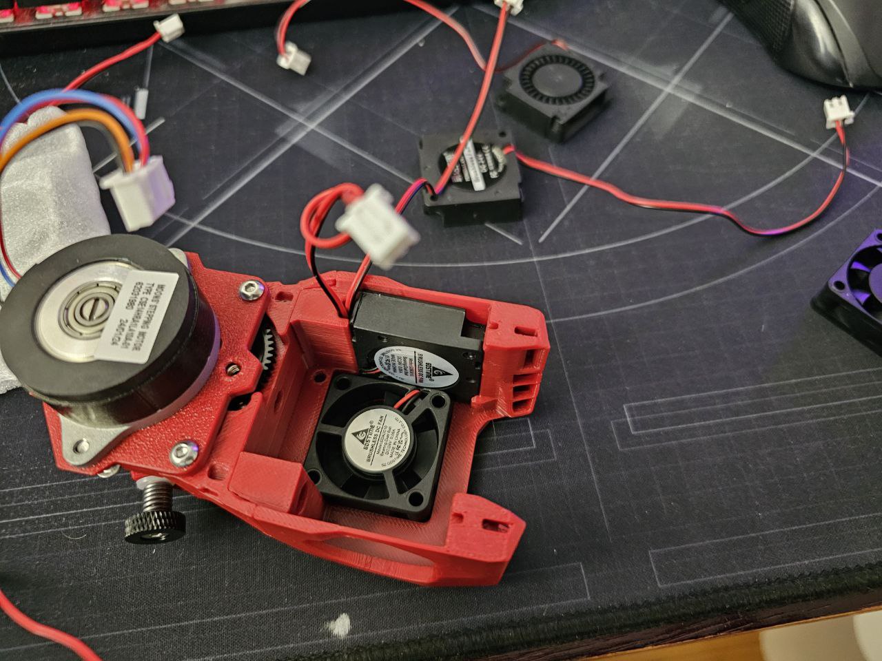

I've got everything to move the printer to basement, but I need time, and yesterday I've changed DOCENG brushles fan from hotend to slightly better chinese brand GDSTIME ;)
And I've found that I did not screw 2 screws inside the printing head xD, but it was working without it with no problem, but now they are there ^^.

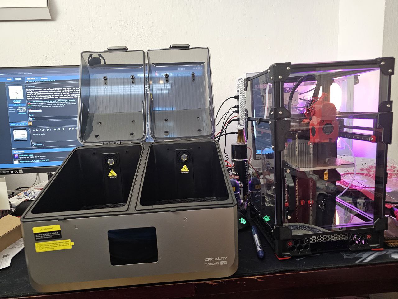

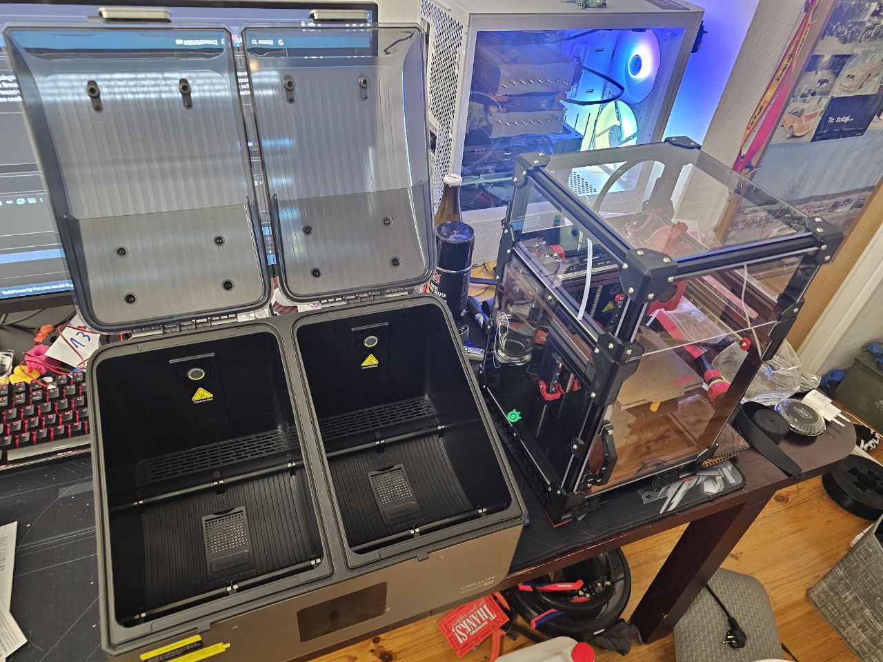

And dryer has come:D
Nice! Gonna need to buy or build a dryer as well. We had so much rain lately, that a spool of PETG can't survive as-is for longer than few days. My new spool is already weaving spiderwebs like crazy :slap:
