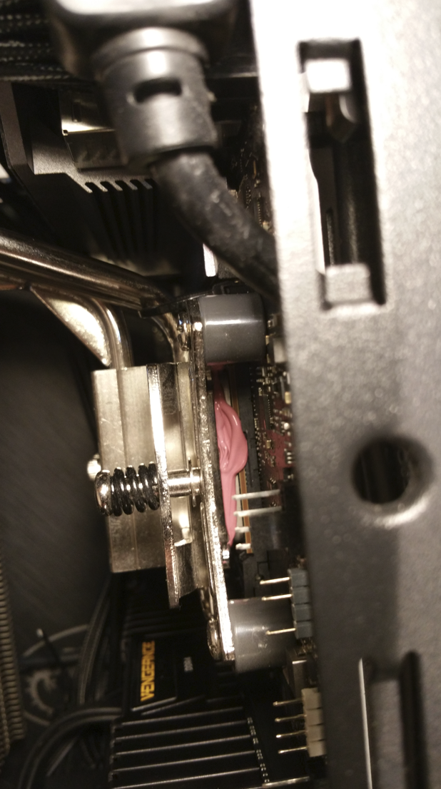

I started at 6am and ended at 11:30pm with a few breaks in between (lunch, dinner, planting tree in backyard, and kids birthday).
  • The ek offset fittings for the rad worked perfectly! The new rad just barely fit into the side compartment and the replacement screws worked to secure the rad though the back of the fan holes except for 1 mount out of 12, it was just too short to latch on, perhaps bad machining on the rad.
  • The fans gaskets were a failure. There are a bit off with the screw hole sizing and too flexible to form a seal with the holes around the LL fans. I'll just have to replace the fans or just leave it as-is.
  • The CPU swap with my spare machine was completed however it almost didn't work.
    • Admittedly I forgot to reset UEFI/BIOS to defaults before swapping CPU's
    • Initially it would not post the Old CPU until clearing CMOS and a few reboots later. Then it wouldn't boot by shutting down without warning. Then I set the SOC to 1.1v manually. Previously I was doing that on the ITX board because it would do 1.2v by default for no reason at all. After that it would refuse to boot windows (I forget the error message). Windows managed to fix the problem after a few reboots.
    • Ran OCCT tests for 2 hours no failures or WHEA
    • With new thermal paste the OCCT CPU and RAM tests for 1 hr peaked CPU at 79c on the NH-C14S air cooler
    • The old CPU is running my ITX's DDR4-3600 ram no problem (still have to test RAM OC)
  • I had an idea about sound damping material for the distroplate but I lost the material.
    • Hopefully the hardware store will have something tomorrow. (discovered today during the teardown I can't use washers for the distroplate so that option is out)
    • I have an alternative very thin packing material I can cut up and use so maybe some double sided sticky tape will be enough with that.
  • Took lots of pictures but too tired to upload them tonight.
  • Tomorrow I disassemble and clean the distroplate and GPU, replace the pump, and hopefully start reassembly.
It's been an exhausting 3 days. Some things went well, some not so well.

A bit dusty. Top exhaust tends to trap dust behind the mesh and you can see where my NH-C14S fan intake is by all the dust in the dust filter.
Unfortunately this case can rattle a bit so I ended up putting some anti-vibration pads in critical areas of the case panels.
Let's see what we've go here. When I replaced my Corsair 600w SFX with 750w SFX PSU it came with sleeved PCIe cables but the pigtail connectors at the end made things difficult with my RX 6700XT so I'll be fixing this while swapping out the CPU's.
Popping off the top panel you can see my zip tie wizardry mounting 2 Artic slim fans. At first I wasn't sure if they would work well but they seem to work well enough.
