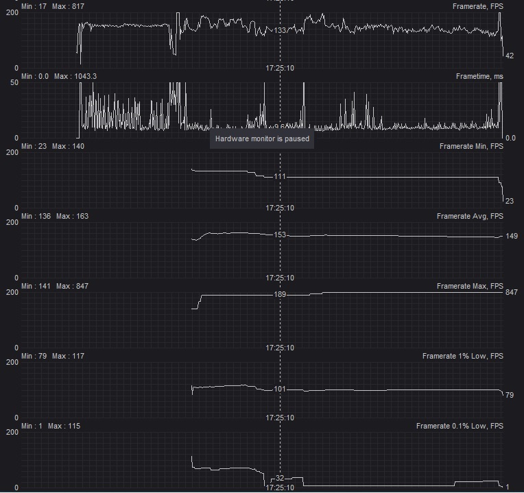

UPDATE: I have included Afterburner graph while playing Warzone. The line in the picture is roughly where the game play starts. Can anyone see anything wrong with my gpu? Or it is performing good? Even though the 0.1% low and 1% low seems to be very low values.

I doubt it’s the application. I will try another application but if the issue still happens what do you think it is? Is my gpu faulty or something else?

Hmmm not sure why the 0.1% low and 1% low keep dropping to a very low value or a one digit value. It seems to happen when I am in the application for a period of time, when a scene in the game changes or loading, and also when alt-tabbing. Not sure what is the cause and if my gpu is faulty or not.

Do you see those 1%lows drop to low value during gameplay or when the game is loading? If you dont experience low framerates during gameplay but only when the scene changes or you move to a different area of the game and it has to load data, it is OK.
Happens to me as well with windows 11. There is small stuttering. Sadly, its the ecores, or better yet windoww scheduler sending tasks there, and then the cache down and upclocking based on whether ecores are up or not. Only happens at call of duty though
