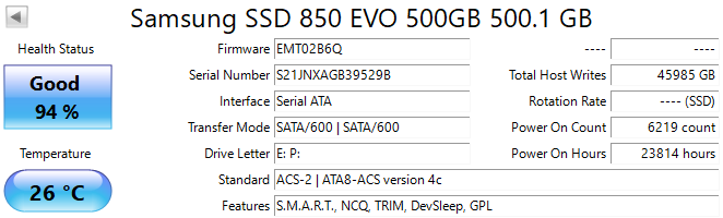

P.S. For example. Here is my secondary SSD,barely used for it's age(at least 8+ years old) 1TB written but look at the hours. It's at 97% life.
But if logically thinking here that only extensive writing is killing them then i should be at 100% still:
Mine is about the same age, slightly less hours, but a lot more total writes, 3% more wear than yours.
Originally this drive was the primary for 7-8 years, with separate page file partition.
~10TB writes in 6 years is like a drop in the endurance bucket though.
