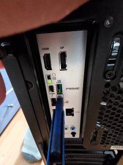

No LEDs on the board that I know of, the manual doesn't mention them either saying the case power LEDs are used for diagnostics. And since pressing the power button does nothing (no fans either) I'm left with a single green LEDs that turns on when I attempted to use the USB BIOS Flash tool.
Yes I can attempt with the old power supply but the reason I got this new one was because the same thing happened with it.
I've attached a picture of the LED for bios flashback.
