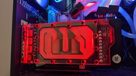

Yup I`m at my wits end too with my 3090 X Suprim, I have EK vector trio water block and the EK backplate on mine ,After 10 mins you cant touch the back plate,
Just wish they did a they did an active backplate for msi suprim 3090 :(
