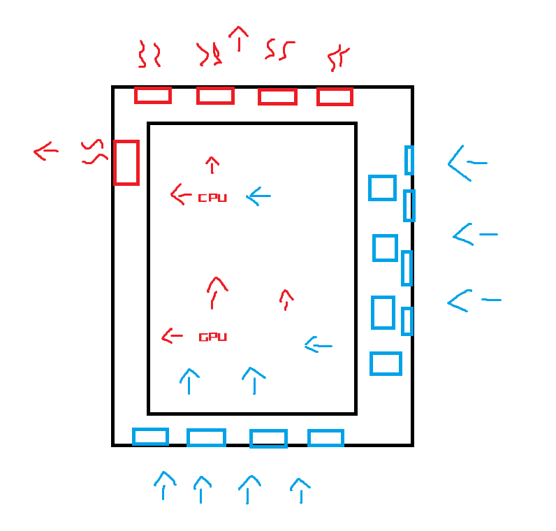

OP doesn't need to do this. His case has plenty of airflow.More fans usually isn't the answer. If your case is becoming a hotbox, you should first properly check for the flow of air - remember, hot air is less dense than cold air at the same atmospheric pressure, which means that essentially, due to buoyancy, hot air inside your computer case floats upwards - "hot air goes up" generic statement.
Very bad mspaint drawing, but this should be easy enough to understand. If your temperatures remain out of control, you've either got a problem with your AIO (see if it's installed correctly, and if its pump is working). GPU has issues with paste (rare if your card is less than ~3 years old but can happen)), or you're simply pushing too many watts for the cooling system.
In many cases, if you're starved for cool air inside the case, simply removing the side panel tends to drop temperatures by 40°C+.
As you can see, the entire bottom quarter of the side is mesh. This photo also shows two 120mm fans on the PSU shroud. This Lian Li marketing photo is stupid because it depicts the PSU shroud fans exhausting downward. Ideally the airflow should be directed upward (drawing fresh air from the PSU compartment mesh) as I recommended in my original reply.
OP doesn't have any exotic power-hungry components. It's a Ryzen 5700X and an RTX 3060. The CPU has a 65W TDP
and the GPU is about 170W. Absolutely nothing this case can't handle.
