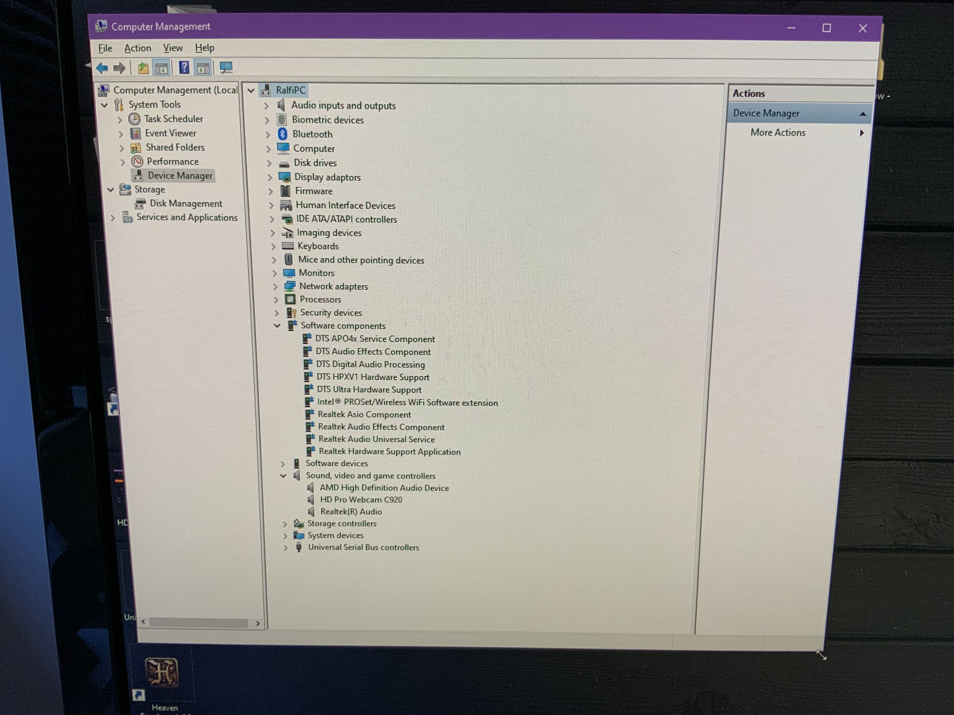

Ok, starting the process again.
This is what I get in Device Manager after restarting (about 3 times now)...
Realtek Audio remains after uninstalling it. & there are a heap of DTS Software Components (are these from my first fail attempt at installing your driver & if so, should I uninstall them all? They may belong to my motherboard?).
Try uninstall everything DTS related, and all Realtek or AAF audio drivers as in the guide, if not, use DDU, Display Driver Uninstaller, as suggested by another member, in the "uninstall audio" option, i know that the guide mentions to not use third party apps for uninstalling drivers, but in my case it was the only way to uninstall drivers to stock, only then i could delete drivers and extensions using pnputil, hope it helps and lets wait for ferather for more advice.
I have not tried DDU, I am not sure if its ok, the driver store explorer app breaks things I know that for sure, it doesn't remove registry entries and caused a major problem with updates.
I do use 'Device Remover' Device Remover 0.9.5212.27342 for Windows - Download (uptodown.com), but usually I just use Windows pnputil.
You may also need to unplug your PC's network cable or turn off WiFi, so Windows doesn't download drivers, or interrupt installs.

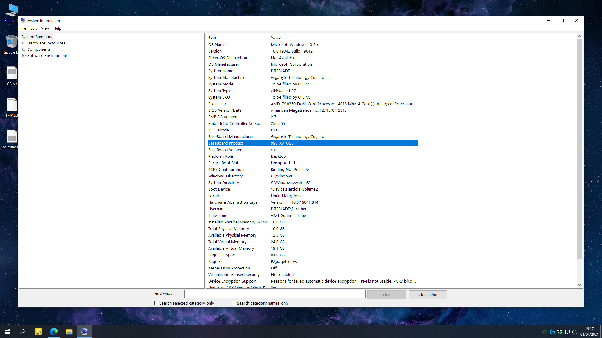

Same the images I provided, Gigabyte GA-990FXA-UD3 (rev. 4.0) with ALC889.
@seiya1
I may have to borrow your PC if you are willing, the latest edition (which I know has the original name: DTS DCH 6.0.9129.1), should be working if the dated version does.
I checked it over yesterday, this being said, it appears you may be having trouble with Windows based on the issue you had removing the driver.
The main driver should now support all chips, where the alt drivers are secondary support, due to some changes.
