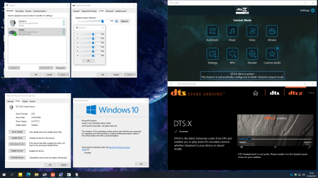

i am getting this. not sure whether this is right or wrong after applying the hdmi reg patch
Its correct, great work. You can switch to multichannel if you setup the file then restart APO4 service and Windows audio. Once the reg files are setup and you have restarted 1 time.

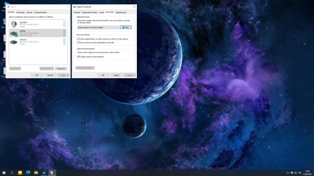

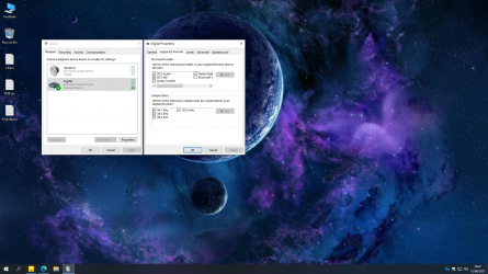

well darn no luck main and alternative both do same thing Ultra is shown to be set to multi channel but you can not select it from with in windows just reverts back to off for spacial sound and dts decoding is still broken :( question tho could a bad policy install be a cause for this by any chance?
@Ferather so i figured out turning off enable audio enhancements in windows audio settings for spidif allows the dts decoder within windows to work the dts x and headphone x video plays as intended and DTS-MA files play as intended as well still you can not enable dts ultra in spacial sound tho but getting closer idk if ultra still works with enhancements off but it still says its active for multi channel tho idk how to test if its really working
Interesting. Spatial on SPDIF will only enable if Interactive and 6 channel setup is disabled, the Ultra and Headphones versions are for stereo 2 channel setups.
Another option, in case you have an OEM lock, try removing the EFX_51 key from SPDIF, when in multichannel. Some more harsh locks may put you on stereo only.

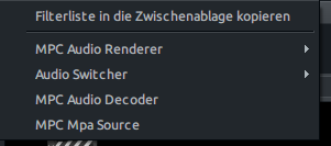

Hell why I need to touch a running system. Stupid - thanks to the Outbound App It looks like something messed up with dts:x - It would not recognized anymore by the THX Speaker System. I hope a restart helps out.
Edit: ok working again. Using MPC:BE
Maybe I will the player you've mentioned because in MPC:BE it takes a couple of clicks to get all infos for audio-processes

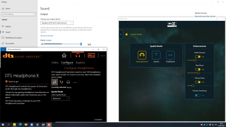

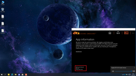

I decided the purchase the Retail edition of Sound Unbound (2021.2.6.0), I can see they moved things, but the Ultra mode is still there and working with the preset.
The Ultra:X option is removed, however I simply enable the Headphones:X (same engine), and turn off headphones, all Ultra modes work.

Could you give me the link if the new DTS X Ultra app, please ?
@ajf64, enhancements need to be on. @Hearick, if you own it, uninstall the older free one, open the store and download the current one (you can also turn on auto-updates).
And if I start the DTS X Ultra app, I Will have the same settings than in your screenshots ? (Spatial ones)
I think, because in my case, when you start the Unbound App you get the Spatial Ultra Settings. It is a little bit confusing
Each mode has its own spatial setting, the one I showed is the custom mode (make your own).
Edit: Yes it can be confusing, even more so if they move features.

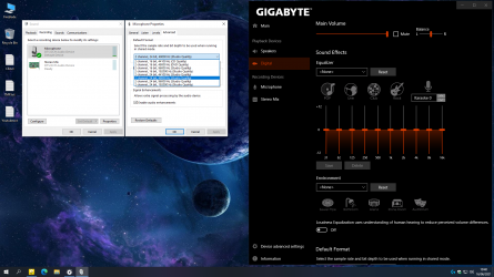

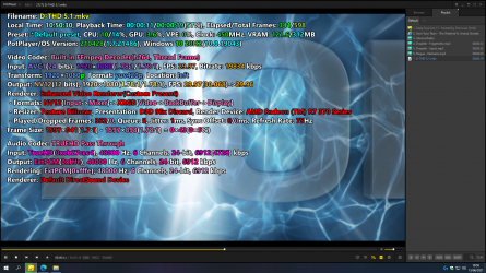

So my GA-990FXA-UD3 (rev. 4.0) with ALC889, based on testing should do 50+mbps, currently I am working on some registry hacks, to see what I can do.
The second image is Dolby TrueHD fully decompressed, ending at just under 7mbps, in this setup its lossless to lossy Interactive:X.
On analogue, you will get the fully decompressed lossless played through, but still sounds worse.

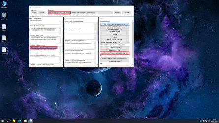

Do I need Equalizer APO to add EFX ?
No, here is a video for the DTS Interactive pack, you only need to do the EFX part near the end, the rest is included and done.
In some cases starting with stereo, then enabling and adding Interactive, might work with some ALCs.

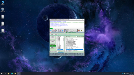

ALC 889, with custom policy (see 'RTK Device Tool.txt' in \TOOLS\, and this video),
