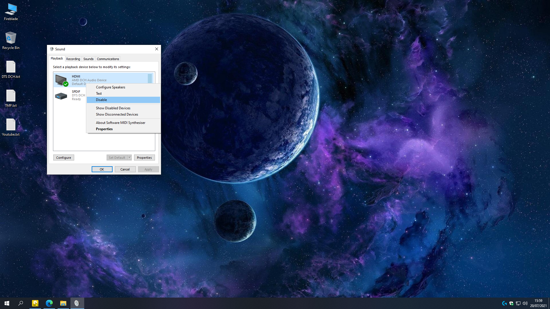

@drnick88101, with the Realtek driver installed I use 'DTS Settings' and FX Config. Open FX, and select the AMD, then select 'Copy GUID' on the right.
Make a backup (also on the right), edit the .reg file and replace both {DEVICE-ID} points with the GUID you copied (paste it).
Disable the device via Windows settings, apply the .reg, change the format (see this video).
For Interactive, you select Interactive, disable, and repeat restore the .reg.
