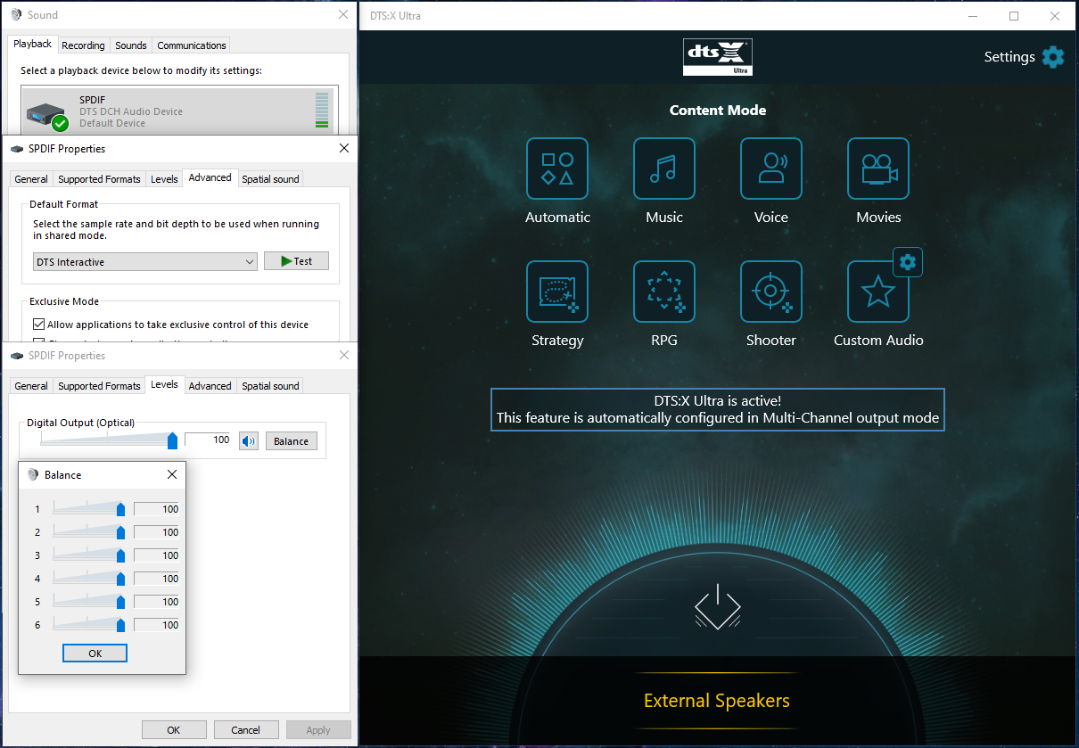

is that for stereo upmix dts settings or interactive as well
Its a Realtek update, and the Realtek APO is on all endpoints (Speakers, Headphones, SPDIF, HDMI, Bluetooth). I completed the driver inf files, and have set code to manually register.

If you are using speakers with the retail Sound Unbound, enable Headphones:X, then set headphones to none.
You can use all 8 active DTS:X Ultra modes with all of the Sound Unbound modes, or without.
You can also turn off Ultra by pressing the power button, at the bottom.
