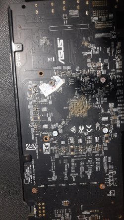

Please remove cooler and make a clear picture of the whole PCB. I will try to locate the correct bios based on the information I find in the picture.

If you used atikmdag-patcher, your problem is not solved. You just worked around the problem. You are still using a wrong bios.
Remove the cooler and make a clear picture if you really want the correct bios.
Yes facing matters friend i have attached images bellow. Thank for your kindness..

Can you make a photo of the backside of the PCB?
Likely the correct bioses for your card:
