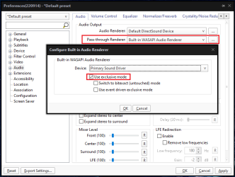

That was a quick reply-thank you very much! I have tried Wasapi API in exclusive mode with the same gibberish coming from my speakers. The bitrate settings were indeed very confusing for me as I expected only 1509 and 754 kbit/s. My receiver only takes AC-3 and DTS. With the information you provided I guess the app is trying to squeeze DTS-HD through the SPDIF connection or something. My receiver says he is receiving DTS and I can make out some veery distorted dialog. DTS passthrough works flawlessly.
Potplayer will send all formats down SPDIF when in WASAPI exclusive, indeed the method being used to transcode PCM to DTS in the FF encoder is not great, but that's not Potplayer its self.
You should probably stick to DirectSound (legacy) mode, so that Dolby Digital Plus is transcoded to Dolby Digital (normally), and DTS core (DTS Surround) only.
