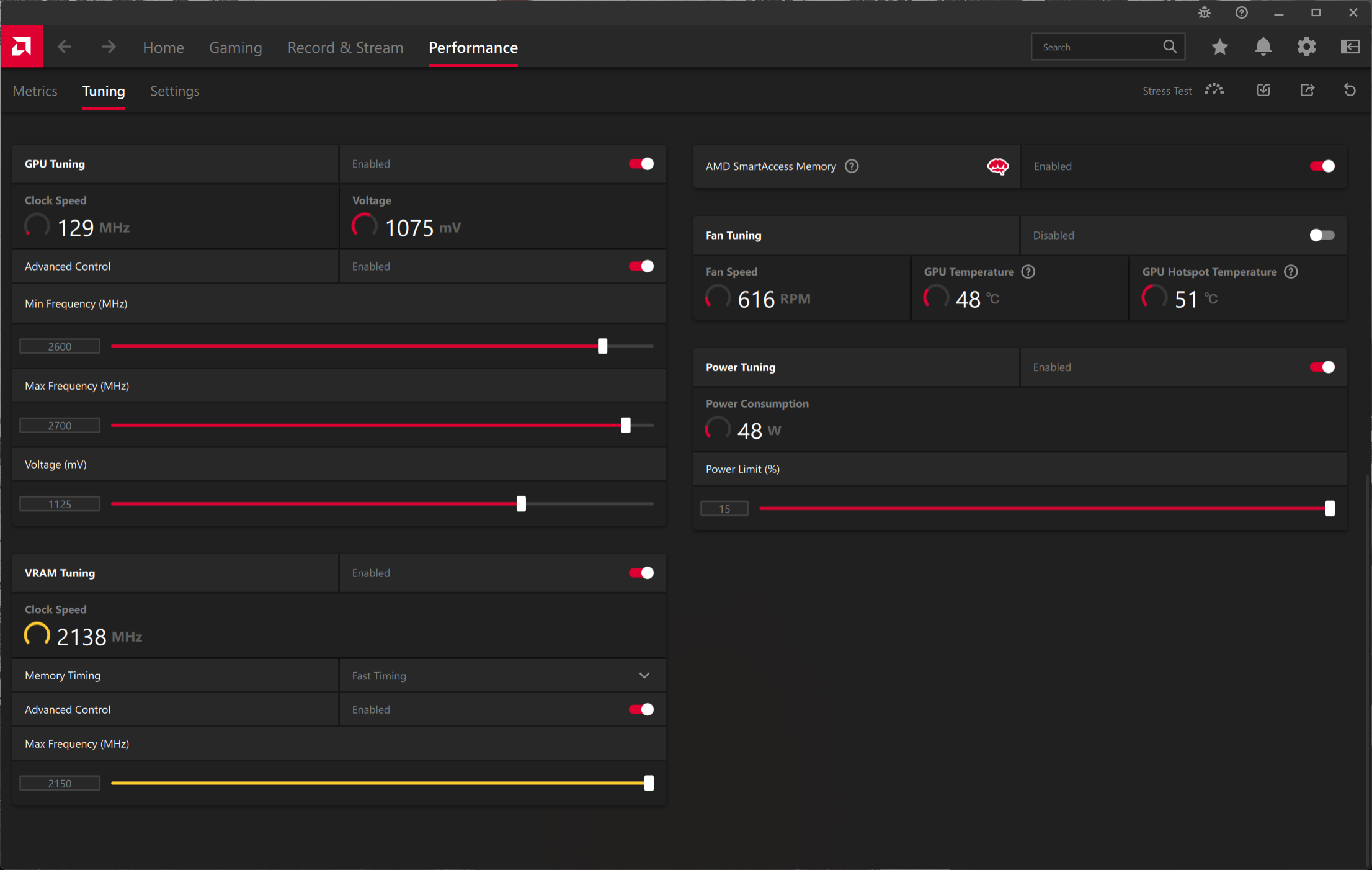

Undervolt it. I run my Powercolor Fighter with these values.
I had it at 1.05v, and I can't remember where but it was freezing coming out off a specific application or benchtest, I realize 1.2v is only a mild undervolt. Runs at 1.45 or something like that out of the box. I was not trying to Max it out, was only looking to up the performance a bit to hit a Target FPS for a specific game and get my temps under control. This is why I called it a moderate overclock. If I did not, I meant to.
