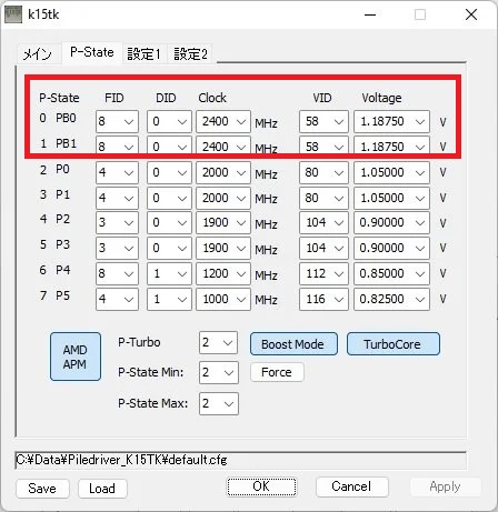

Focus on those two, PB0 and PB1 is boost clock, you can lower the boost clock just use the drop down, and the voltage on far-right side is the voltage for selected clock. You lower this to undervolt.

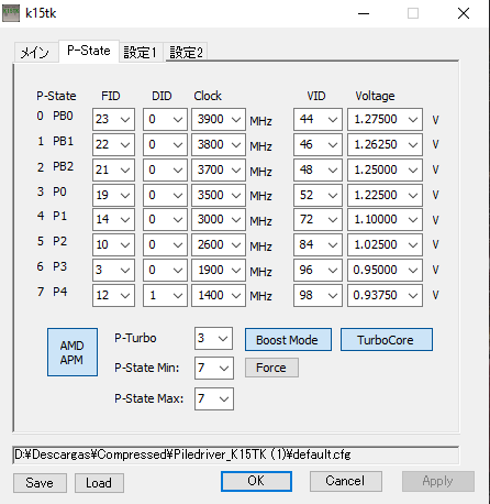

Ok so this is my k15 screen.
I changed my power plan to performance so the cpu clock keeps at 3.9 and decreased the voltage to almost 1.2750 that is the max base clock speed voltage and it's ok but anyway, as soon as I start any stress test the cpu changes to the P2 state (2.6Ghz/1.0250v) and keeps there all the time till I stop the test and the clock goes up to 3.9 again in a second.
What stress test program did you use? That is odd behavior, if I'm not mistaken if you set the PB0 voltage lower the other voltage follows, correct? Can you show me the screenshot when you set it to 1.275V on PB0 I wanted to see other P-State voltage.
No, the other states voltage still the same if I change the PB0. I use the AIDA64 stability test but have the same problem with TimerBench.
OK I must've mixed up with another program. You should lower the voltage on other P-states then, the CPU power management could gone haywire when it detects PB0 voltage is lower than lower P-states. Make sure it's lower than the PB0, it should be stable, then try again to stress test.
Is this fine?, tested AIDA stability again with these settings and it's just the same, it changes to P2 state.
It looks ok to me, have you tried to disable AMD APM there? Also try to restart and run the program again.
Or...you can just force it to run at PB0 all the time, you see the P-state min and max below? Set it to 0 for both and press Force :D
