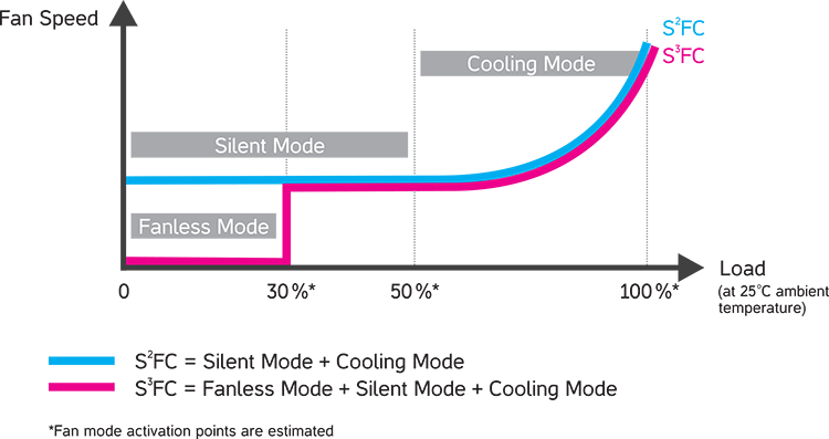

Seasonic Core does not have fanless mode though.
:( Did you follow your own link? Scroll down and it clearly says,
S2FC - SMART AND SILENT FAN CONTROL
Which is not fan-off mode, as the graph on that same page shows. The fan will always spin, but not at maximum RPM.

Gee whiz! :( It seems folks are so eager to show where someone else is wrong, they don't even look at their own sources! :(
according to seasonic, S2FC is not fanless.
Many PSUs have a feature where the fan does not start to spin until a certain thermal threshold is crossed inside the PSU.
DF - If you look at your own graph, it clearly says "Fanless" Mode! And look at the graph and at the magenta line, it does indeed starts at 0 RPM. That's off or "Fanless" to me.
Assimilator - If you look at that graph too, note also the "*" and how it says " *Fan mode activation points are estimated." If not activated to until those points, that means is NOT spinning until those points.
Now if you guys don't believe your own sources, go tell Seasonic they are wrong, not me! But please don't refer to graphs and links that don't even support your inaccurate claims. :(
