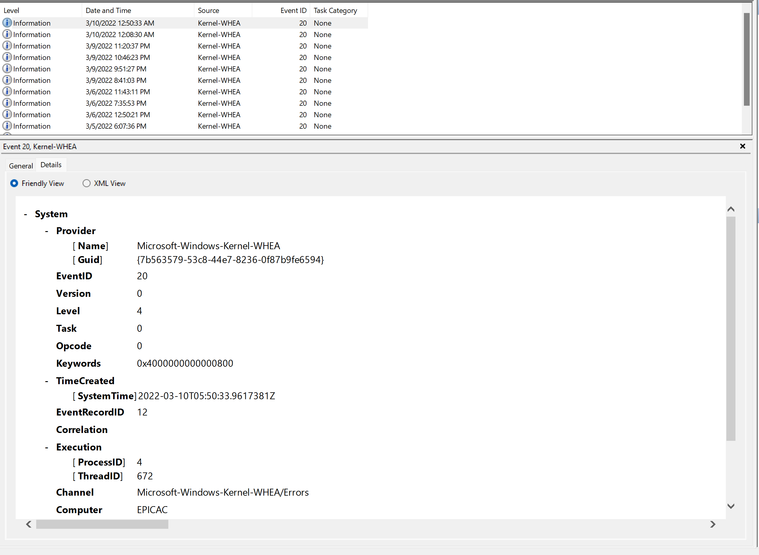

Likely a sign of being unstable. Are you seeing any non-fatal WHEA errors?
Would I be finding that in Event Viewer? Like Event Viewer>Applications and Logs>Hardware Logs?
EDIT: Nevermind, I found it. Applications and services> Microsoft>Windows>Kernel-WHEA. Checking now
These are the only WHEA errors I have. Event ID 20. Quick search, looks like something to do with a driver, but all of my drivers should be good. I've gotten this error a few times a day each day that I've gotten it. I cannot remember what I was doing on those days specifically. I have messed with different OC control almost every day the last week and this specific error hasn't shown up every day so I kind of don't think its directly correlated with and overclocking, although I could be way wrong about that.
