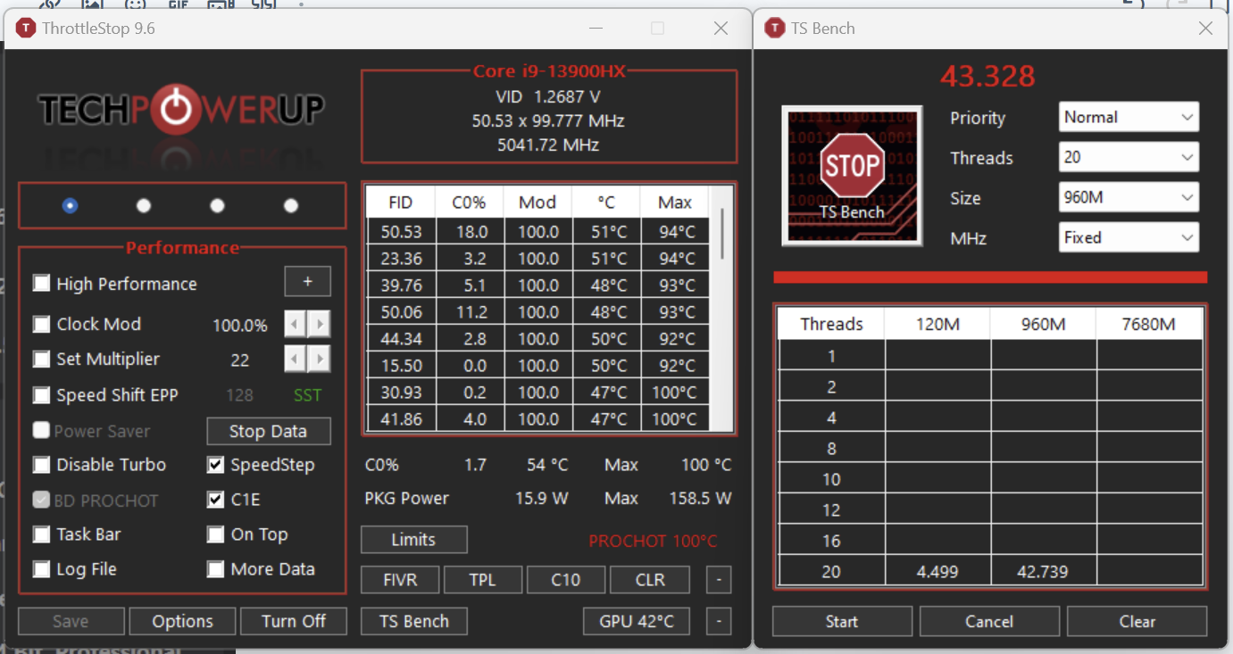

Hello all,
I've been using the software very well for years on my old predator helios 300, this software basically made the lifetime of that setup much longer because it does shave off several degrees and that machine was so hot stock.
But now I cannot use it with my new Alienware m16 r1, it is a i9-13900HX RTX 4070. This is another toaster, it get ridiculous hot so fast.
The menu in FIVR does show it is protected like img below
so how do I unlock this thing without screwing up my computer? My firmware is 0.1.14.1, windows automatically force updated it (tho I'm not sure this has anything to do with it)
I already disabled all the virtualization in the Bios, already uninstalled the virtualization crap in windows 11 too. Like img below
Maybe I skipped something? Or do I need to boot that secret menu to disable the undervolt protection like this video:

When ThrottleStop reports that Undervolt Protection is enabled, you cannot use ThrottleStop to undervolt your CPU. Undervolt Protection has to be disabled before you boot up.
The advanced menu shown in that video is exactly what you need to access. Disable Undervolt Protection, boot up, and you should not see Undervolt Protection in the FIVR window anymore. Once that is got, you can undervolt.
Everything else looks OK. If you want to test that ThrottleStop is working OK, instead of an undervolt, try applying a small overvolt. Set the offset voltage to +5 mV, press Apply and this should show up in the FIVR monitoring table immediately whether Undervolt Protection is enabled or not.
Post your results if you get this working with the hidden BIOS menu.

Hi thank you for the reply. Yes TS now shows it is working, but the temps still run high with current levels of undervolting.
what happened tho is that both benchmarks got a bit better, it was something like 4.7 and 45.xx IIRC.
Should I align the other items to the same undervoltage? Like Intel GPU? I aligned only the Cache so far.
Anyways, I'll notch the offset down bit by bit and test throughout the weeks and see, but I guess I need some sort of fan control too and I'm not sure the thermal paste is good or not (with my previous helios 300 I also changed the stock thermal paste to a better non-liquid metal one), but people are saying those alienwares come from the factory with better thermal paste from Dell already and disassembling them is a known pain in the butt (inverted MB).

Can you post a screenshot of the entire FIVR window (without cropping)?
You have a Nvidia GPU so in most situations, the Intel GPU is not going to be consuming a lot of power. Most people do not bother undervolting this. If you do decide to try and undervolt the Intel GPU, undervolt both the Intel GPU and the iGPU Unslice.
Most people do not undervolt the System Agent. Some users have reported that undervolting the CPU E Cache does not accomplish too much. The Core and P Cache are the two most important voltages to adjust.
the other params are stock ones, didn't change anything but offset voltage, the offset was done over the "performance" profile that comes stock with TS.
but here it is (notice that now I just put the intel GPU and iGPU slice under the same undervolting value)
Yes, they're standard for your computer, but not for mine. Your IccMax as standard is 230 A and I have 240 A, and that difference makes a lot.
Lowering the voltage of the Intel GPU and iGPU more than 50 mV doesn't really make sense, but lowering the IccMax value for the CPU Core and increasing it for the rest of the components makes for real tuning.

Ok so I've done -100 and it seems -120 works, but strangely the single core benchmark didn't chance at all. This is with -120
The same tests with TS Benchmark gave slightly better results in 120M, but worse results in 960M

Ok so for anyone searching this later on: I cannot put -150 undervoltage, windows freezes and it doesn't boot (actually doesn't log since I've put TS as a task to initiate upon logging, NOT upon system startup), I needed to reset undevoltage lock to boot windows. So far -120 seems to be stable. I gamed a bit, ran cinebench, downloaded things, used browser and restarted windows several times.
Do you have -120mV for core and cache?
Try maintaining -120mV in cache and lowering the core.
It can probably reach -140mV or -150mV.
