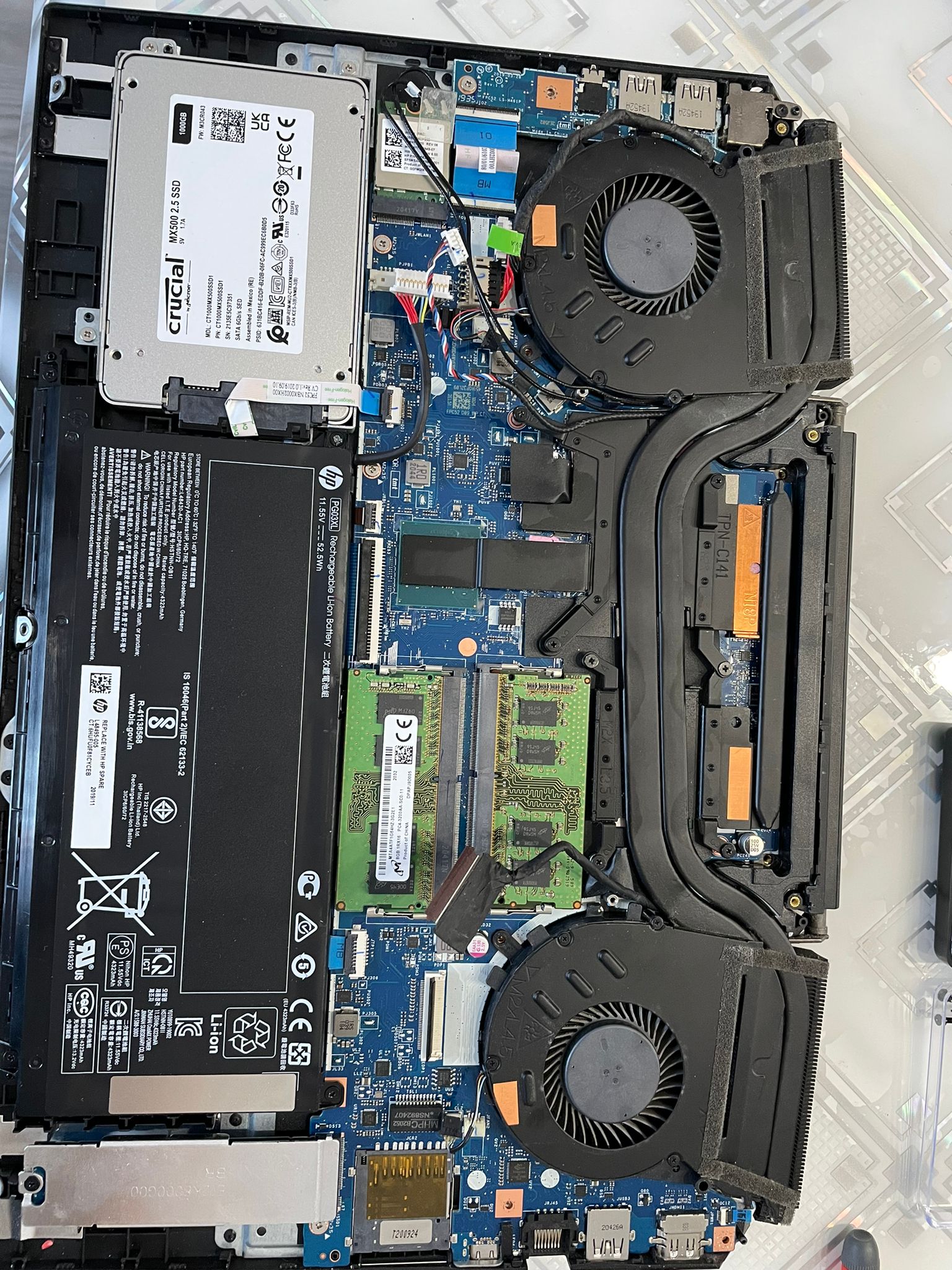

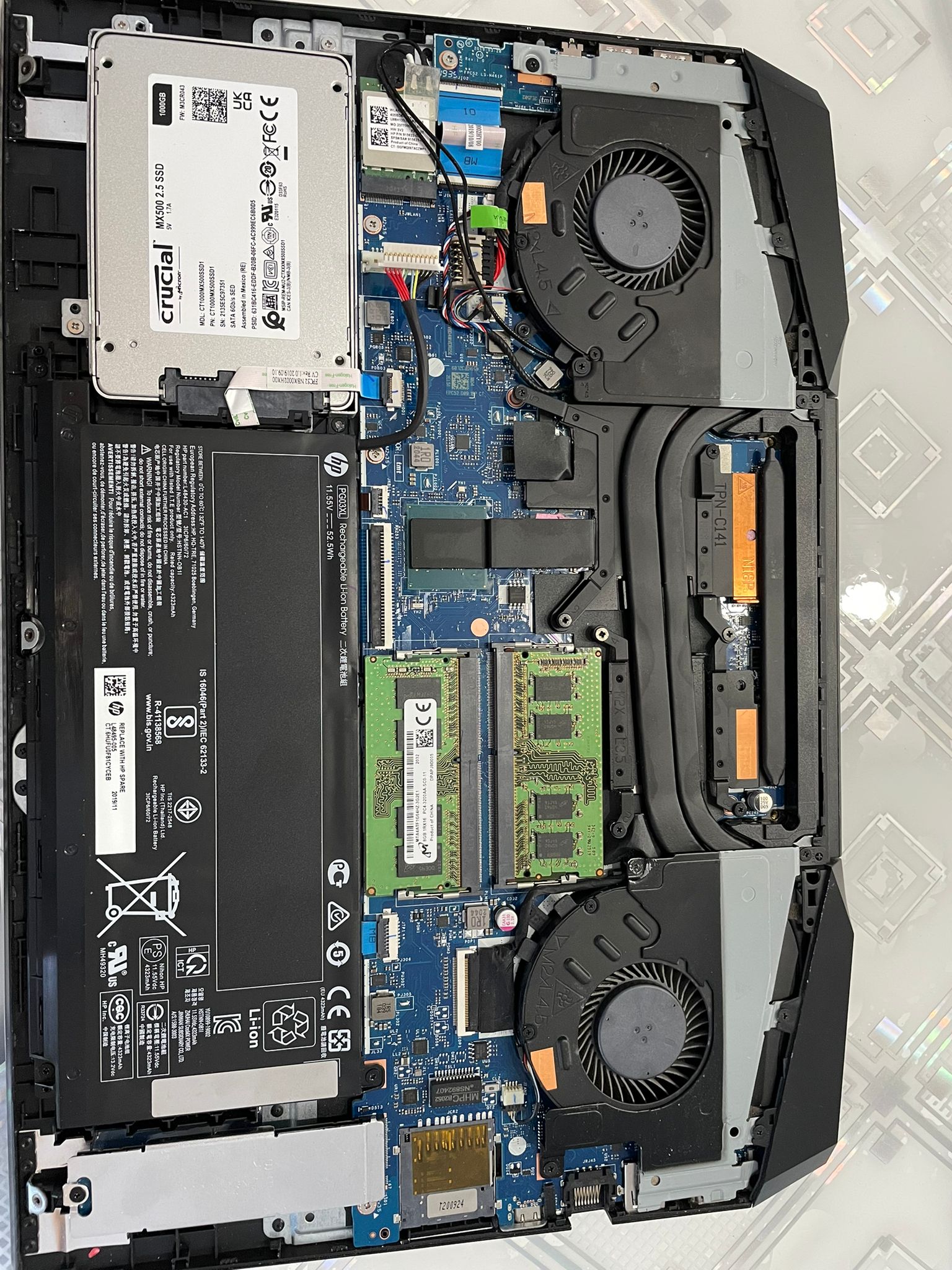

The problem is solved, Im shocked how unprofessional they are.
From installing screws to thermal paste...

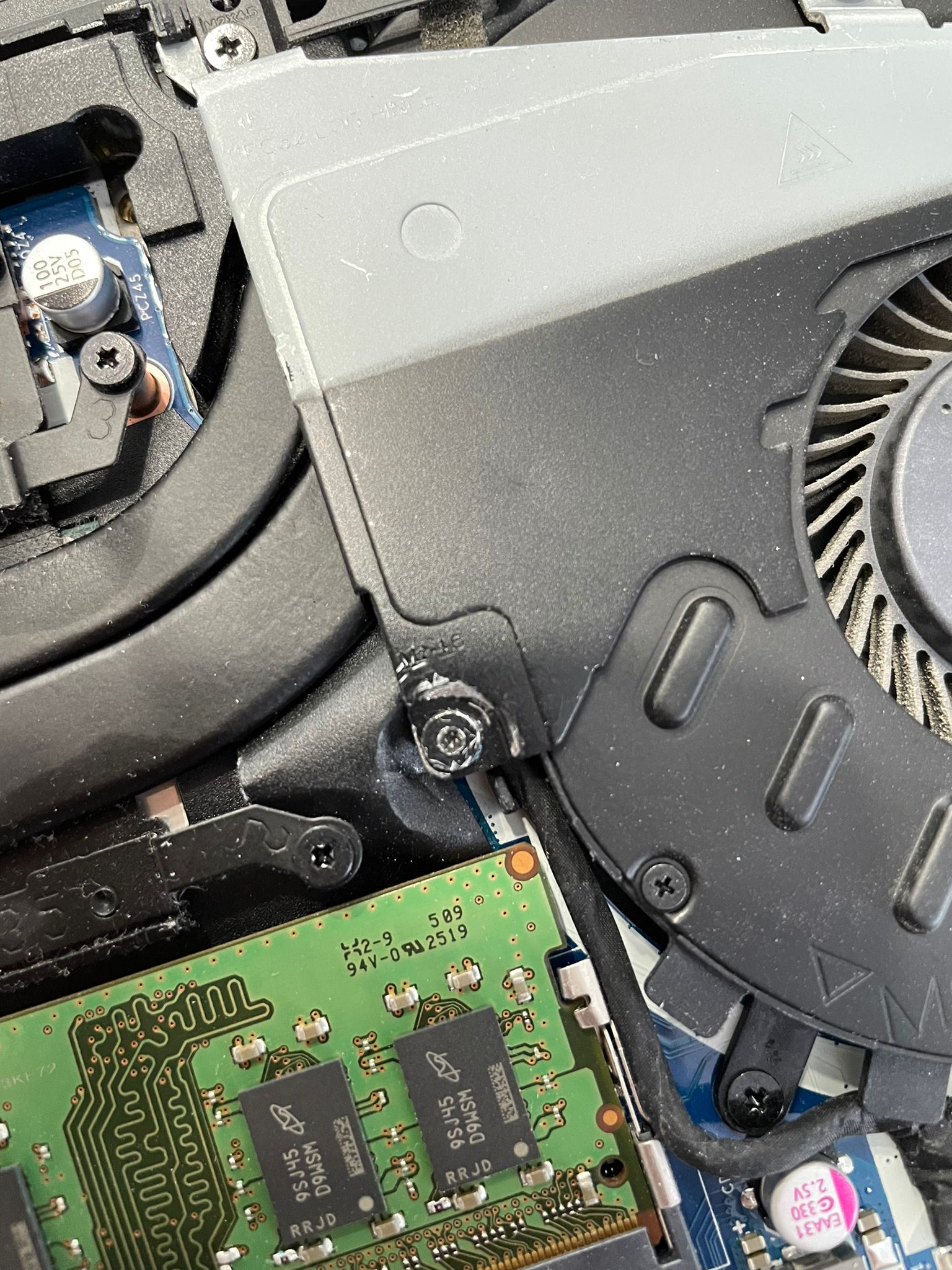

The third picture show a cracked end of the heatsink, do I have to change that or is it negligible?

Your core temperatures while running the TS Bench are varying by 15°C to 17°C from core to core. If this causes any performance problems, you will have to redo the thermal paste and try again. Uneven temperatures are usually caused by the thermal paste or by a heatsink that might not be perfectly flat. Keep an eye on things and see if it improves or gets worse during the next week or so.
I'm shocked how unprofessional they are.
See if you can blow some dust out of the fans. It looks like a crappy job by HP service. When you see how unprofessional some shops are, it makes sense to learn how to do this job yourself. If one of the screws holding the heatsink down is stripped, that might be why the heatsink is not making even contact on all cores.

I tightened the heatsink as best I could, for that very reason. Applied the thermal paste and spread it with a plastic tool. We will see.
I blew out the fans and heatsink with compressed air and cleaned it with a non-electric brush.
