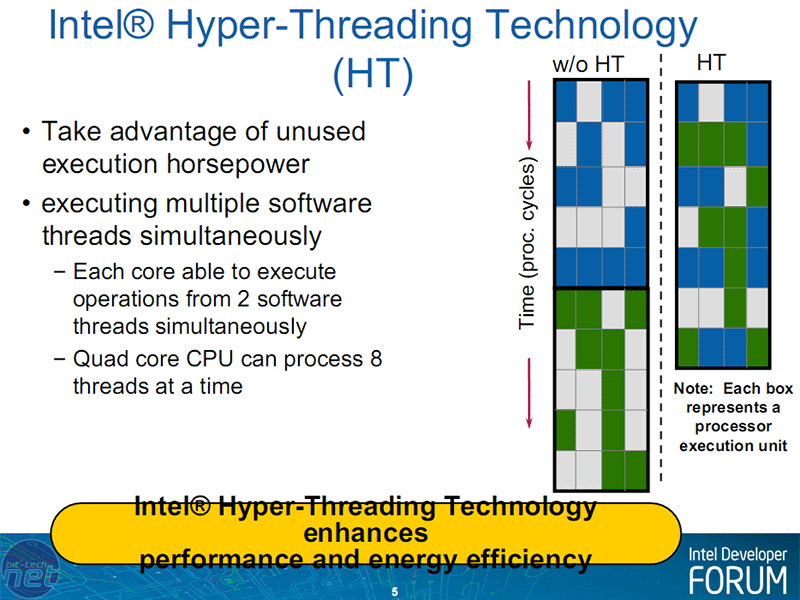

HT isn't what makes your i7 fast, man. ;)

24% increase with 8 threads.
11% decrease with 4 threads.
33% increase when looking at home-field advantage (8 on 8, 4 on 4). This is what programmers developing multithreaded software make as the default behavior.
I think the point that is easy to miss is that in the scenario where performance suffered, I think Windows can be safely blamed for allocating the threads improperly (e.g. it had two threads running on one physical core). Regardless of underlying reason why it was slower, the processor also was ~50% idle where the other two instances were 0% idle (presumably). Just because this one task took a small hit covers up the fact that the processor was ready and able to do other, unrelated work simultaneously.
Hyper-threading is typically responsible for about -5-50% performance change depending on workload.
The fact the processor handled 200% threads slightly better than 100% threads speaks volumes to both Windows and the processor's scheduler.

I would agree with you if the improvement from 100% to 200% wasn't something along that lines of 2% gain from 8 threads to 16 threads (4c/8t case) and ~6% for 4 threads to 8 threads (2c/4t case). 2% is within margin for error, so I would consider that unchanged from the previous value. The values for "percent increase" is the improvement in performance is over the last number of threads. So improvement for 8 threads would be over 4 threads. The part that makes me think it's the scheduler is not the improvements over the max number of threads, but rather the difference in improvement for 4c/8t @ 8 threads versus 2c/4t @ 4 threads where the instance with no HT threads excelled. Also the other big thing that makes me think the scheduler is at fault is that 4c/4t running 4 threads was faster than the 4c/8t configuration running 4 threads.
Also the table here is confusing, I should redo the percent increases, which really means the amount of performance per core over 1 thread, not improvement from 4 threads to 8 threads which is really want I want here.
